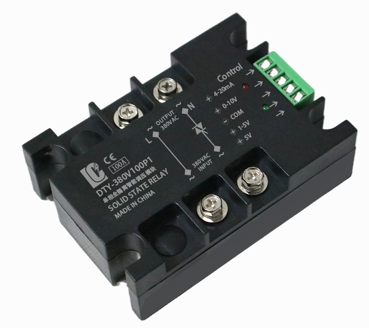

Forget z-wave light dimmers.
You need:
- Single phase AC voltage regulator module 220V (I use 100A for 3kW heater) /20 EUR on AliExprress/
- PWM to 0-10V Voltage Converter /2 EUR on Aliexpress/
- DS18B20 temperature sensor (encapsulated with cable) /2 EUR on Alexpress/
- Z-UNO 2 module - boiler temperature, dimmer (PWM output).
My configuratin for driving three 3kW heaters includes also power relay, two push buttons and Qubino 3 phase smart meter.
It is simple to dimm manually from Android App. For automation > Easy Scripting
If you are interested I can give more detailed instructions...
