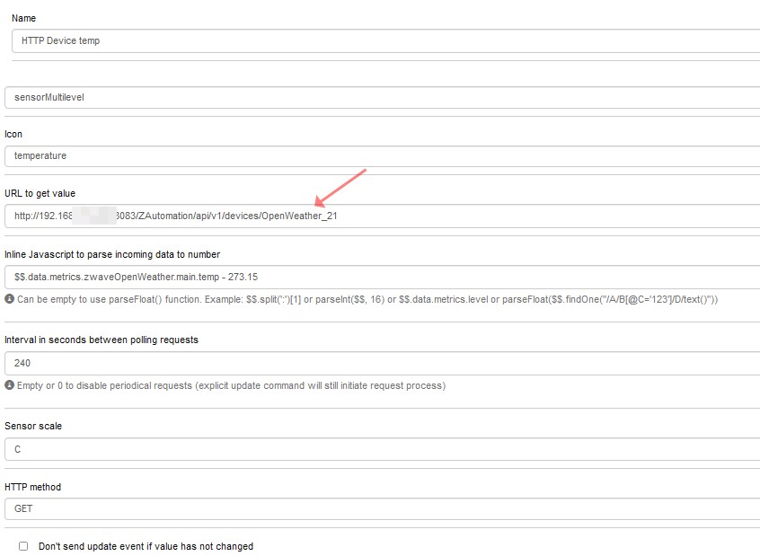

Yes, you are right of course - I haven't seen that this element is a widget with multiple device values...
One simple way could be to create a new HTTP-device and configure it like this:
Use here the device name of your weather device and your z-way-IP - and insert the Javascript line.
Define the refresh interval (here 240 seconds).
But note, that the OpenWeather information will be updated by the App only every hour by design...
You can now use the new created http-device in you rules (I have tested, it is working ;) ...)
There are other ways using JavaScript - so this is ons one sample.
Best regards
Michael
