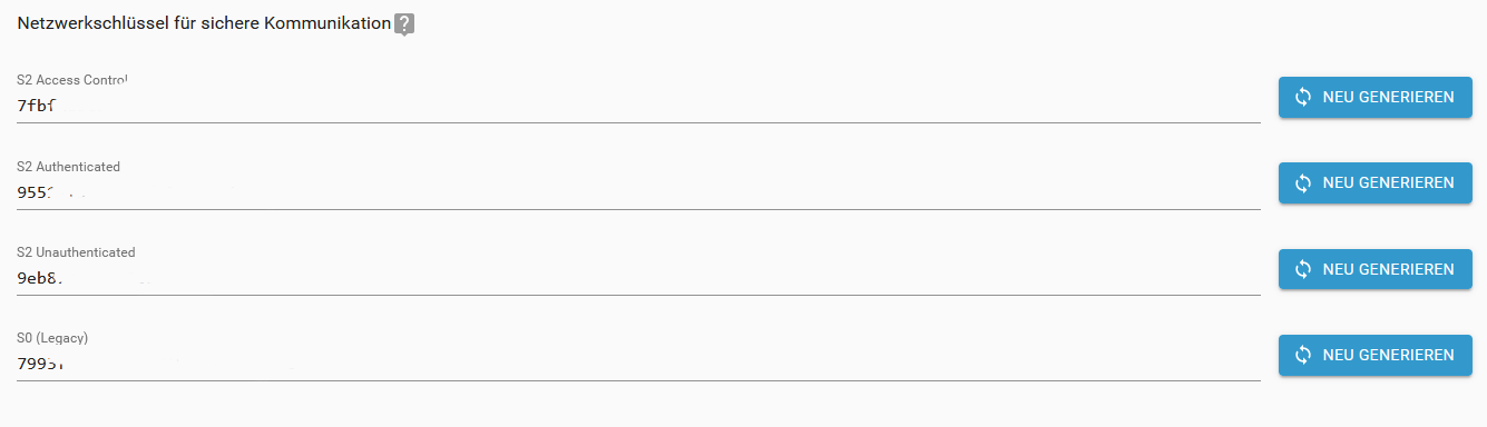

Hello all!
I'm trying to move from Z-Way to ioBroker, because ioBroker offers more extensive possibilities to integrate other systems.
I installed ioBroker on a new SD card and set up the Z-Wave2 adapter. It found all existing devices (controller is the same one I used with Z-Way).
The devices work so far, except for the devices that have been learned with S0. I guess this is because of the network key.
In ioBroker I have to enter the S2 & S0 keys in the Adaper:
How can I read these values in Z-Way to enter them in ioBroker?
Thanks a lot!
Re: Z-Way to ioBroker
Check the Expert UI > Controller Info > Keys
