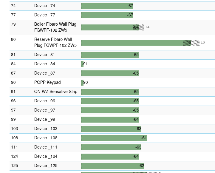

Additionally in Expert UI/ Signal strength for many not existing nodes an entry 'nn Device_nn ...' is shown with signal strength.
Screenshot 2023-07-06 at 10-01-22 Z-Wave Expert UI.png (55.13 KiB) Viewed 30203 times
I don't know whether this is new, but I haven't seen it before. What can be the reason for this?
