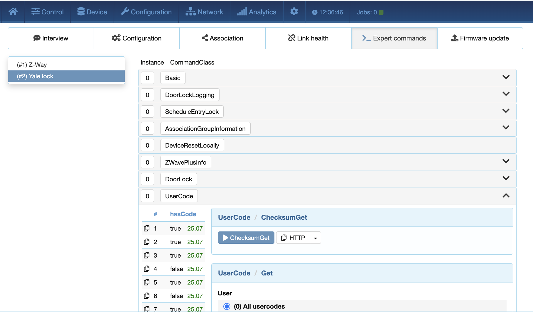

This should be an easy answer, but I am not getting it on my own. I have a Yale lock. Looking within the Z-wave controller's EXPERT administration, >_Expert Commands (tab), for the (#2) YALE LOCK, I have this (see image below).
UserCode section's top view

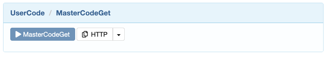

Scrolling down a little further I have a "UserCode" section (containing various commands / Binary settings). I have programmed successfully my User codes using this section. It seems to work great. So my question is where do I see the information from the lock's memory // command an action // check a setting (binary or integer)? For example, there is one button, "MasterCodeGet," which to me means I can use this to query what value the lock has for the Master Code of the lock. This query can be a "HTTP" or "JS" depending on what is selected.
MasterCodeGet
MasterCodeGet

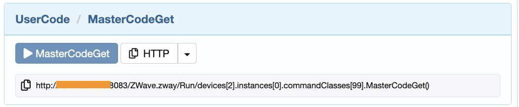

After choosing HTTP in the context box (click on it) the url for the http query is shown (as seen in the image below) and is now in the computer's clipboard (whatever device you are running a web browser to see the Z-wave administration).
MasterCodeGet with http url
MasterCodeGet http.png (30.34 KiB) Viewed 15485 times
Now if I put that http query in another tab of the browser and enter(key) it, the browser screen displays just the text, "null" on a white background (screen). Okay then, a null response to me means it went okay. But where is the Master Code shown for me to see it?

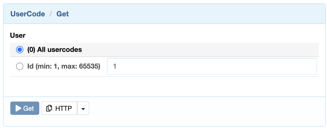

I can further ask how can I see a string of data, like hundreds of User Codes (see the image below)?
UserCode / Get
UserCode / Get

You're closer to successfully fetching the data value than you realize.
By way of an example for device ID=26, Z-Way will return the entire JSON object for Command Class User Code (0x63/99) using the following URLs (they are all equivalent):
http://[IP ADDRESS].lan:8083/ZWave.zway/Run/devices[26].instances[0].UserCode
http://[IP ADDRESS]:8083/ZWave.zway/Run/devices[26].instances[0].commandClasses[99]
http://[IP ADDRESS]:8083/ZWave.zway/Run/devices[26].instances[0].commandClasses[0x63]
Use your favorite JSON pretty printer to format the response into a human-friendly format. I typically copy and paste the response output into an on-line formatter: https://jsonformatter.org/json-pretty-print
By looking at the entire JSON object, you'll be able to identify what information Z-Way has available and how to fetch the data value. For example, to see the data value for the maxUsers parameter in command class 99 for device ID=26, use the following URL (or its equivalents):
http://[IP ADDRESS]:8083/ZWave.zway/Run/devices[26].instances[0].commandClasses[99].data.maxUsers.valueOf()
One point of confusion is that the Get() method does not return a data value. Instead, it returns the status of Z-Way adding a job to the queue. For example, to cause Z-Way to add jobs for sending a Z-Wave Get message to the device for all user codes (i.e., command class 99), use the following URL:
http://[IP ADDRESS]:8083/ZWave.zway/Run/devices[26].instances[0].commandClasses[99].Get(0)
Replace the Get(0) with Get(1) if you want to send a single Get message for the first user code. A Get(0) is special in that it will send multiple Get User Code messages, 1 for each possible user code, up to the maxUsers value).
A bigger source of confusion is that many lock vendors will not return user code values for security reasons. They might return a null value or a placeholder value. Personally, I think this vendor behavior makes sense since it avoids compromising user codes.
Hope this helps.
