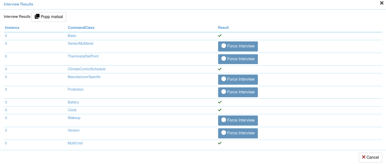

2. The queue-growing issue seems to be solved now, but now it seems that my battery devices fail to get updated.
I have tried "force interview", what does that actually do? It seems that my device is never getting fully interviewed. I have tried excluding and reinclude and same rows are showing as pending.

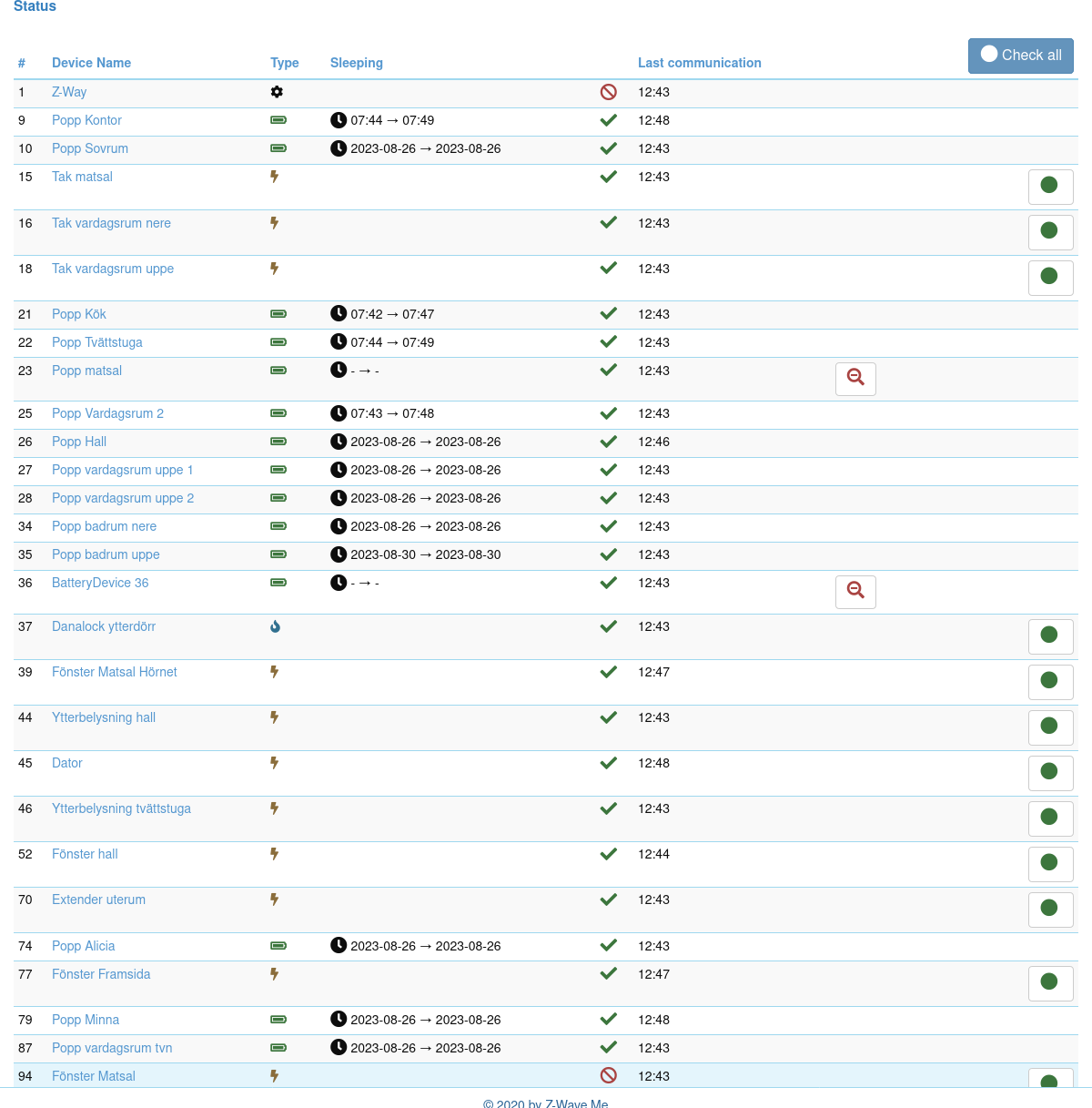

I don't know how to decode this page, the column "Last communication" shows that the devices have sent something atleast, but the "sleeping" column is containing old data.

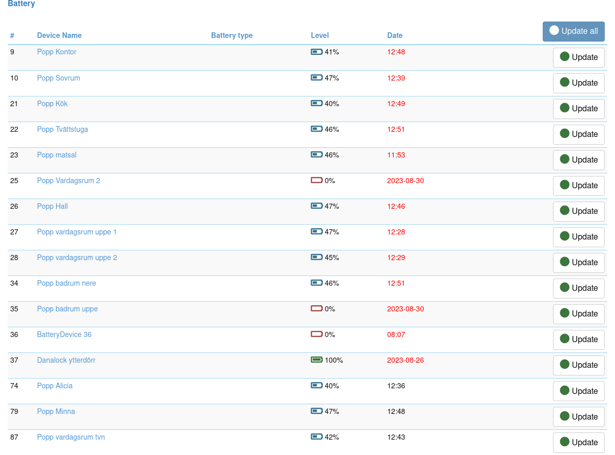

Also the battery page seems to hold old values so it complains about low battery even when I have changed the batteries.

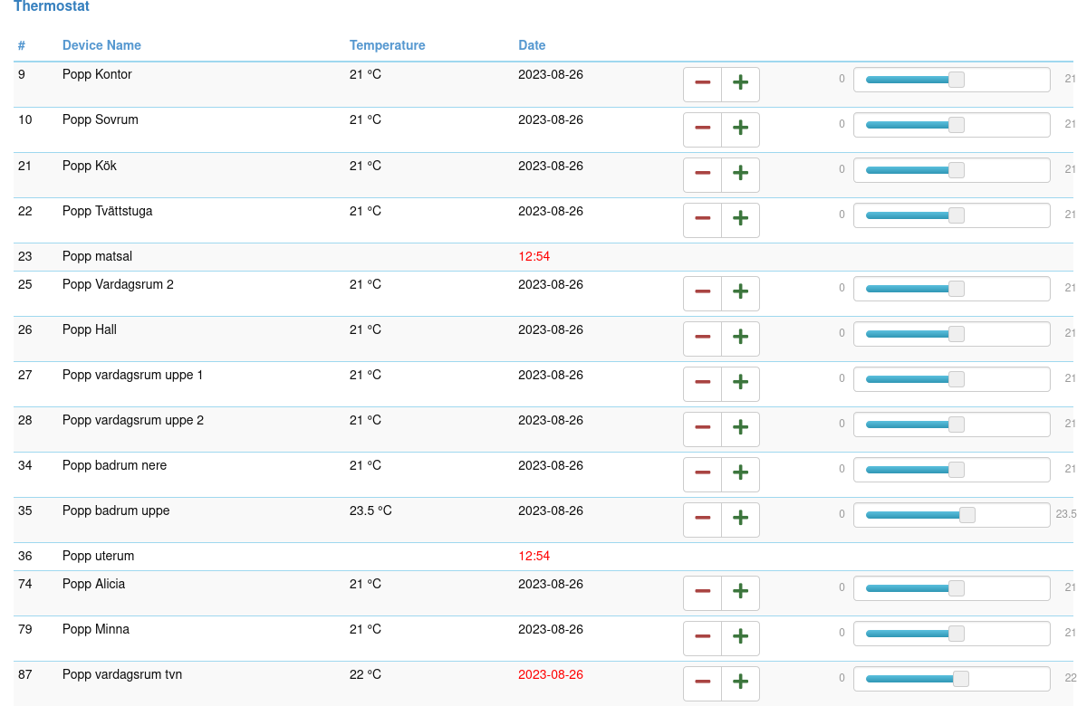

The thermostat page also show old values, I need to manually set the temperature on the thermostat as the value seems to be disconnected from the device.

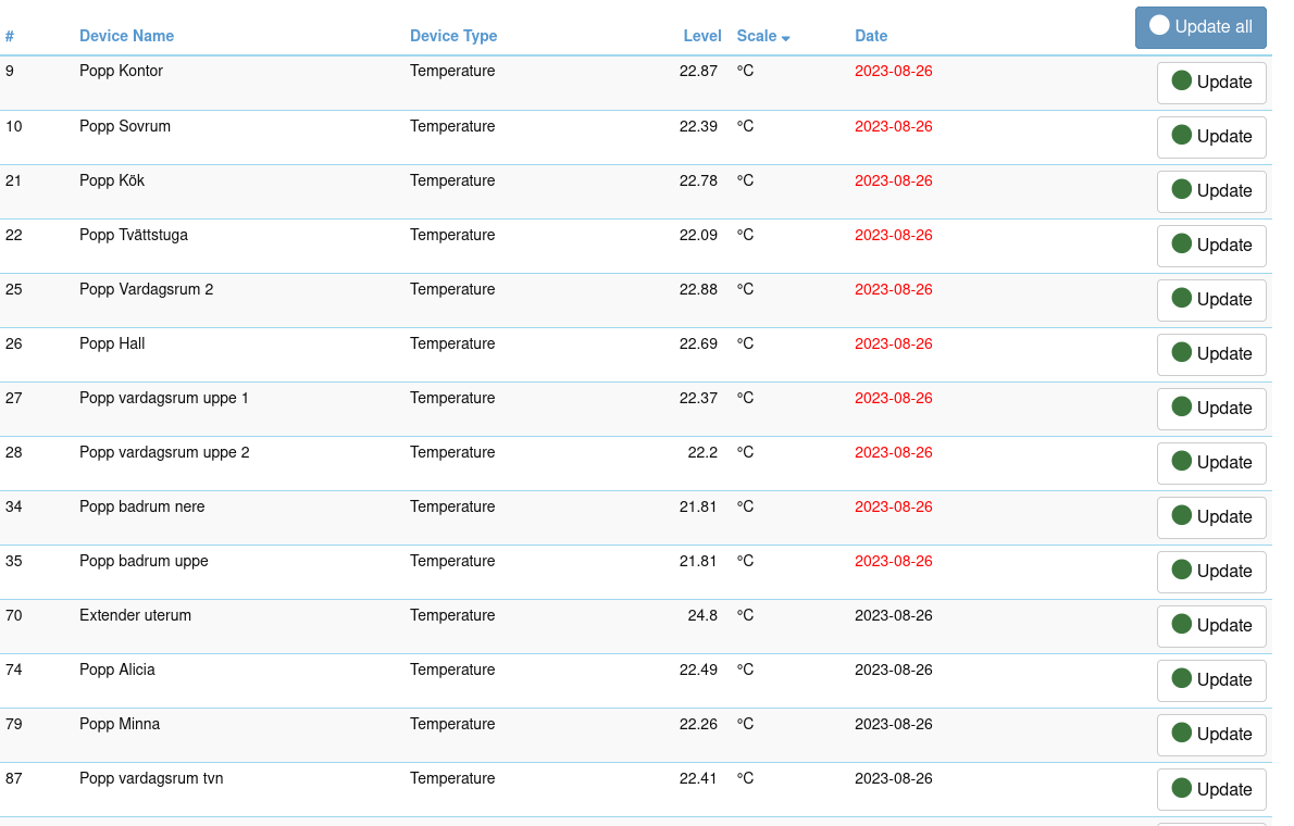

Also reported temperatures are old:

Thank you for asking your question, let's go in order and start with the interview. Tell me do you have this problem occurs only on 1 battery-powered device or are there more such problematic ones? Also tell me do you have such a thermostat in the first screenshot?
When you press the "Force Interview" button, the controller forgets all the "properties" of the device and starts interrogating them again, if you have exactly such a thermostat, then after pressing this button, the device needs to be woken up so that it can pass the interview. Unfortunately, I don't see any mention of 23 devices in the log you sent, do you have the opportunity to exclude this device and add it to the network? Next, tell us what ID this device has and send the log either to support@z-wave.me or to this forum

Thanks for your response and clarification. It's the device you shown picture of.
I found this thread and applying the fix to run in cron every hour solved all my issues.
https://forum.z-wave.me/viewtopic.php?p=98974#p98974
