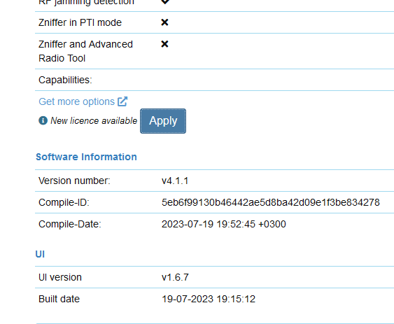

what mean this Message
If I Click on "Apply" Button . Nothing happens.
2023-07-28 07_19_57-Z-Wave Expert UI – Mozilla Firefox.png (14.03 KiB) Viewed 15713 times

What is your UUID? The firmware is the latest one? Please paste the controller data screen (or text) under the firmware subtree.
I think it is a bug with a wrong checksum of the version and because of this, it thinks that a new license is available.
Usually, this button is used to get new features after the online purchase.

The current firmware version is: 7.38 [Bootloader: 1766938484]
I have send you Login data to your Inbox.

I am facing the same problem as you. Please share me the solution if you found it.
Re: New Licence available
Is it a problem? We understand it can confuse, but it should not make any problem

I want understand the Button

It looks like CRC mismatch on our server and on the RaZberry 7. So it assumes new device capabilities are available. We will fix it
