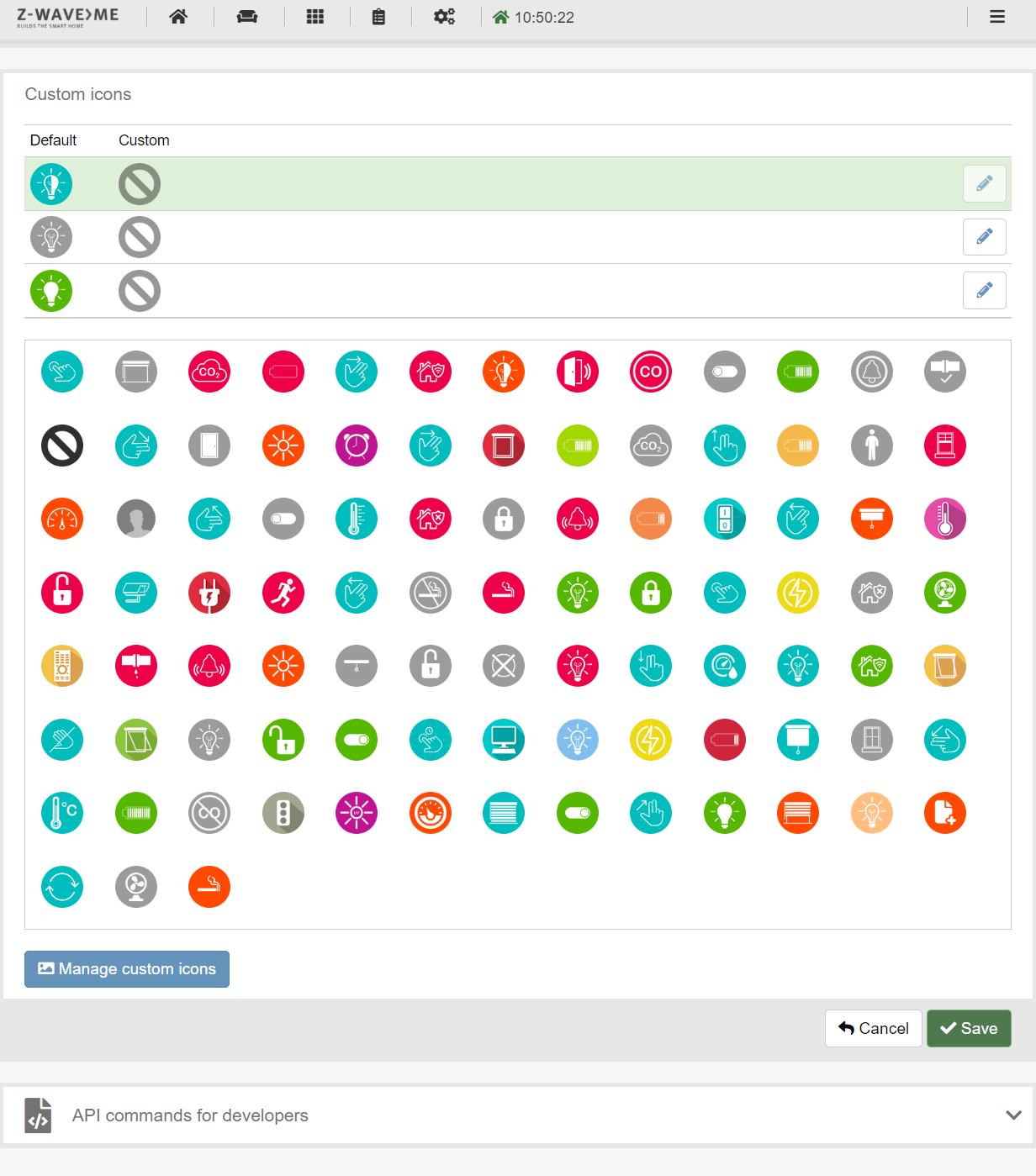

The Z-Way smarthome web UI supports custom icons where a user can change the icons associated with a device. Try selecting the gear icon that appears in the upper-right corner of the device's tile in the smarthome UI and then selecting the pencil icon you want to change. Note that you may need to scroll down to see the Custom icons configuration menu. You should see something like this:
z-way custom icons.png (251.36 KiB) Viewed 34489 times
For whatever reason, the Nice Bidi module reports itself as a multilevel switch (i.e., dimmable light) and not a door lock (see: https://products.z-wavealliance.org/products/3837). You might want to contact the manufacturer to see if they'll update the device's firmware to report the correct device type in the NIF message.

Yes, after zwave.me support, Thery changed from switch to motor, but i ser It like a blind so consequently HomeKit see it as a blind.
Thé question is, can i change to see It as garage door? Not at icon level, at type of device

Your post has me confused. To the best of my knowledge, only the developers of the Nice module can change the device type value that's being reported by the Nice module. Your post stated the device type was changed from switch to motor by z-wave.me support. Please explain how z-wave.me support changed the device type. Did you intent to write that Nice support changed the device type in their module?
As for your question:
The answer is no.
