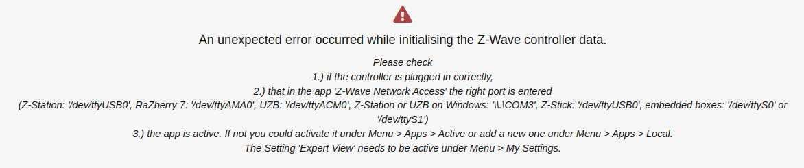

I found another problem, now UART is disabled by default during installation (there is no device /dev/ttyAMA0)
to fix this, run this command:
f=/boot/config.txt; u="enable_uart=1"; grep -q "^$u$" $f || (sudo sed -i "/^enable_uart/d" $f; echo $u | sudo tee -a $f; echo -e "\e[31mUART is enabled, reboot your RPI...\e[0m")- Attachments

Re: Debian 12 Bookworm?
maybe better:
because the /boot/config.txt is now a link to /boot/firmware/config.txt file ?
Otherwise the link will be overwritten (but not the linked file)
Michael
maybe better:
f=/boot/firmware/config.txt ...Otherwise the link will be overwritten (but not the linked file)
Michael
