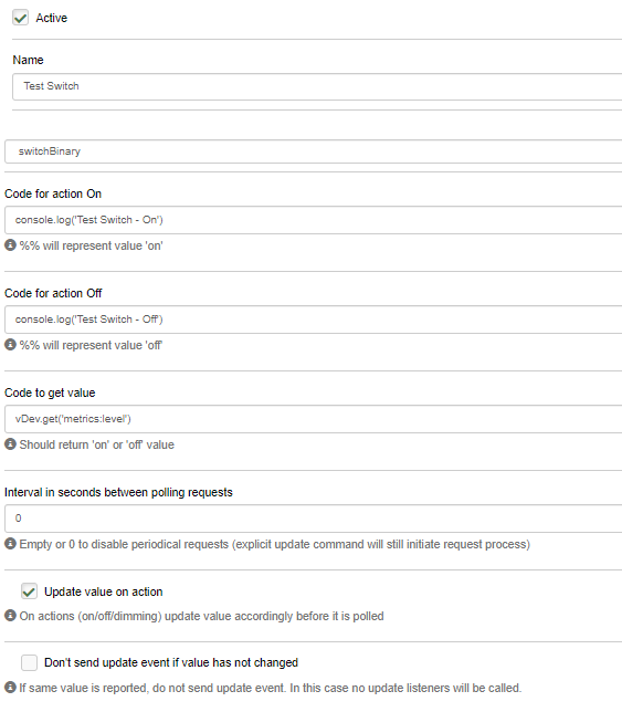

Here's a screenshot that shows you how to create a binary switch using the “Virtual Device (JavaScript)” app that you can use in a rule and control from the “Automated Switch On” app, from the web UI or API.
Test Switch.png (30.81 KiB) Viewed 9296 times
Note that using the “Periodical Selected Switch Polling” app for this device is unnecessary.
