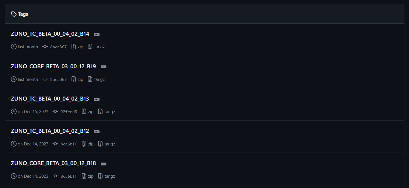

I have a few questions:
  • What are the differences between the ZUNO_TC_BETA files and the ZUNO_CORE_BETA releases files?
  • Which of the Beta versions should I try (including the version and build number) to fix the OTA sketch update issue?

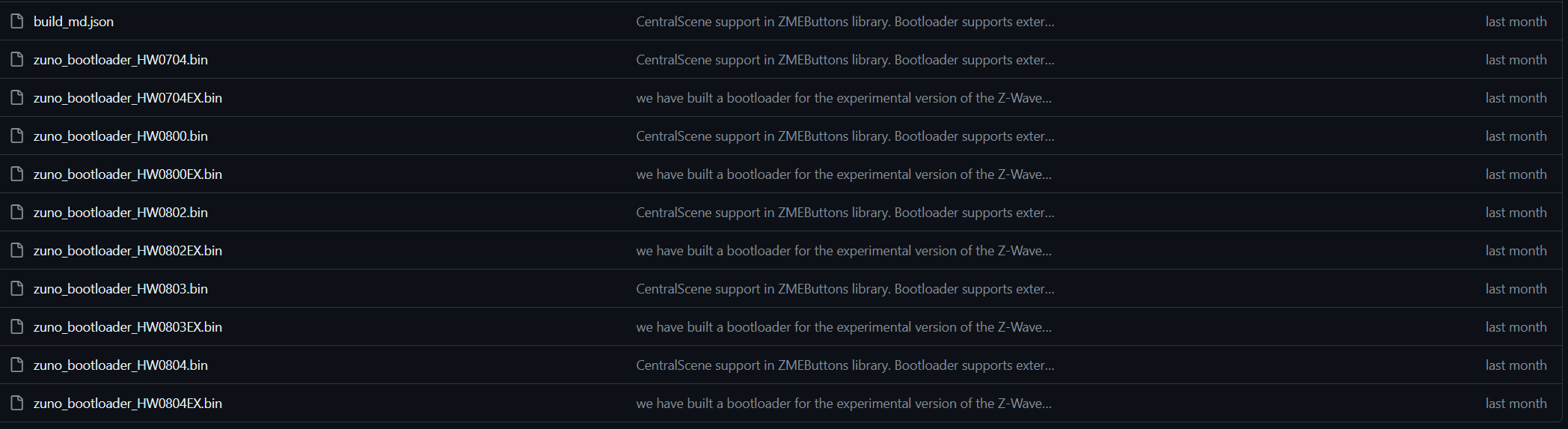

What is the difference between the bootloaders contained within these versions?
What version of the bootloader should I try including the version and build number?
Re: Z-Uno2 OTA Sketch Update Issue
TC is the toolchain (compiler) and Core is the code to be compiled with your sketch.
Bootloaders are for different hardware. The toolchain will pick up the right one. Or open the build_md.json to see the description. You need the HW704.
