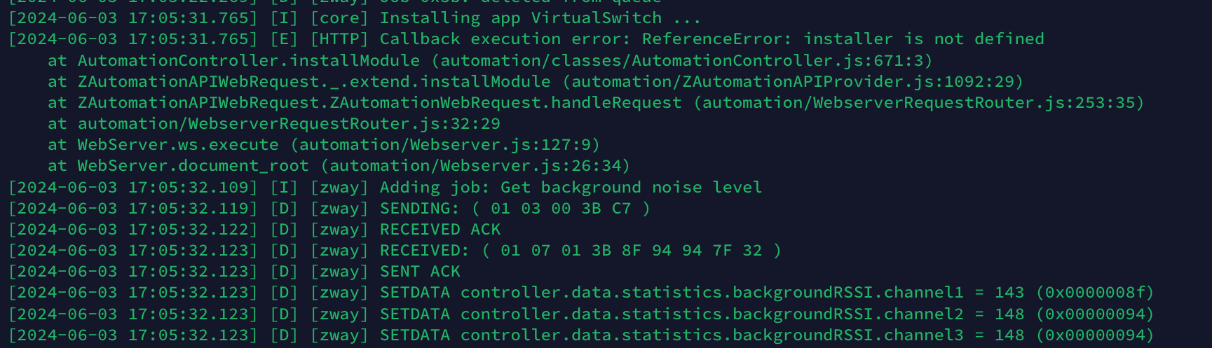

I just managed to install ZWay in Proxmox LXC with Debian buster.
Z-Station (ttyUSB0) is working, but I always get an error Message when trying to install any app. Is there any possible solution, or do a have to use my raspberry Pi with ZWay and the NUC for all other applications (not zwave)?

Re: ZWAY in Proxmox LXC Debian Buster
Please check that libcurl is installed
Run to see errors with loading libraries
Run
cd /opt/z-way-server; LD_LIBRARY_PATH=libs ./z-way-serverRe: ZWAY in Proxmox LXC Debian Buster

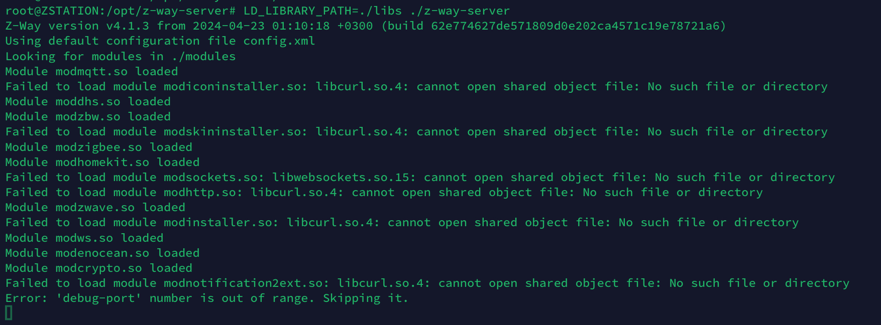

I get some errors when I do this.
- IMG_1020.jpeg (811.19 KiB) Viewed 32723 times
You need to install additional libraries to your OS: libcurl and libwebsockets
Or keep it as is if you are not going to use any functionality related to HTTP requests and sockets

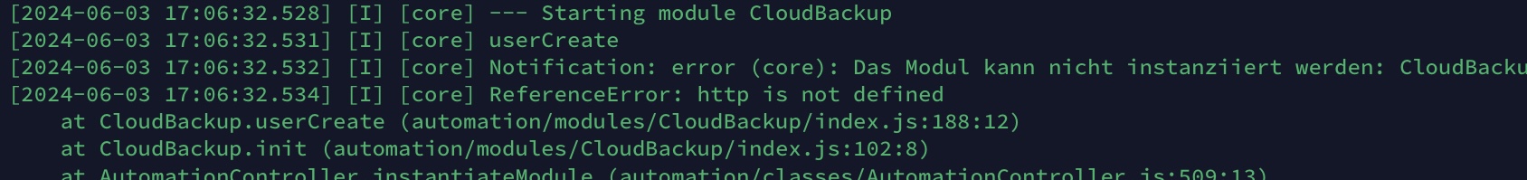

i think i got both installed, but there still seems to be an error.
i installed the backups from my razberry (zab and zbk), some rooms are grey, the icons do not work,...
