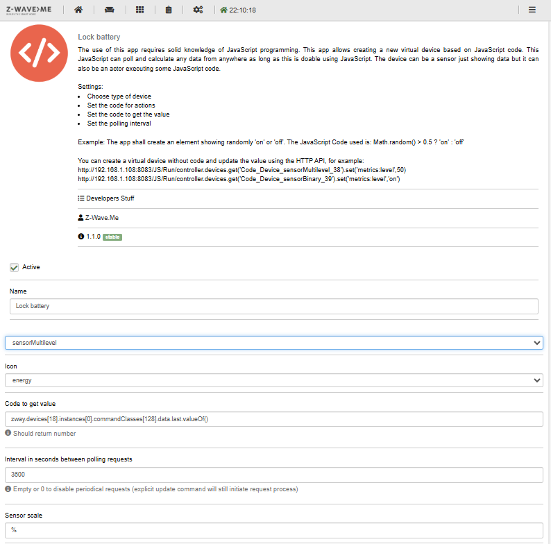

If the value returned is correct, then use the regular UI to install the app called "Virtual Device (Javascript)". Configure the virtual device as shown below. You can create a virtual device for each lock battery you want available in the regular UI and give each virtual device a meaningful name.

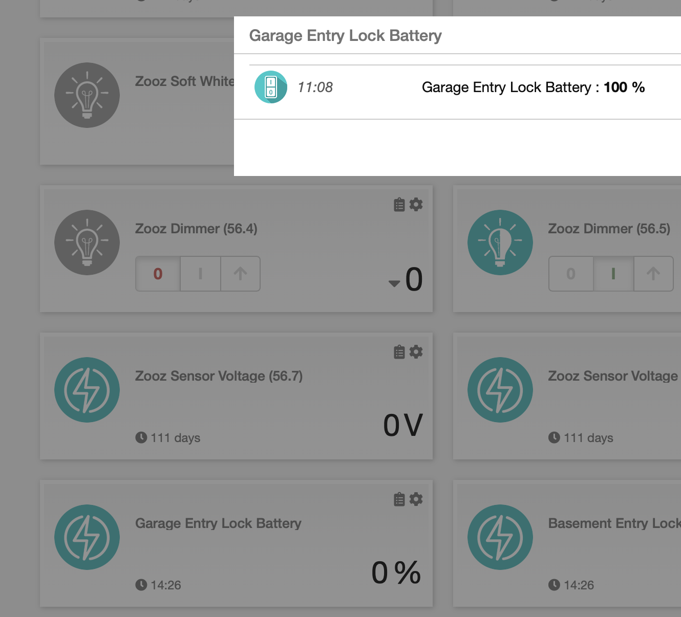

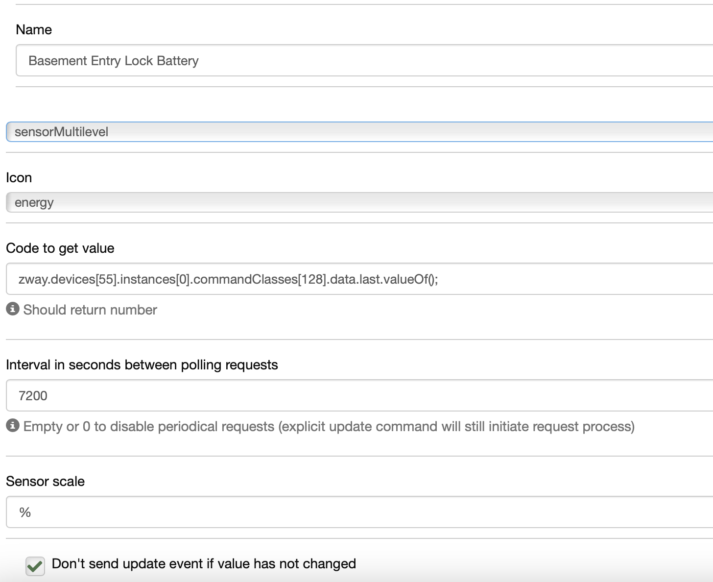

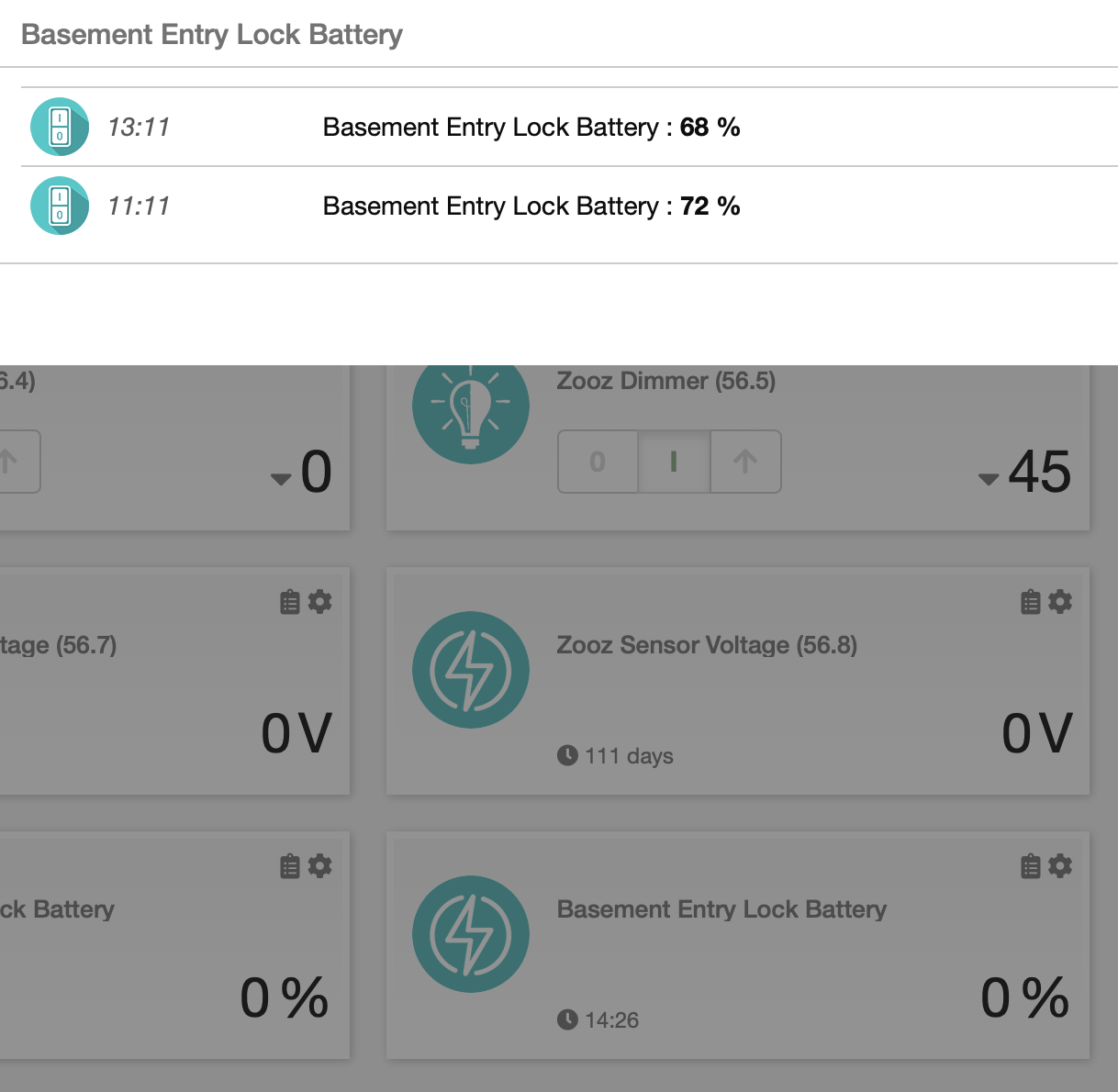

OK, interesting. Something is coming through as there is a history for both lock battery items that show levels. However it is 0% in the UI, and 0% when I make the object visible in Home Assistant. Any ideas?

The virtual device is set up to update its value once per hour. I'm guessing you did not wait for the value to update itself. You can trigger an update by clicking on the clock icon/timestamp on the main UI for the virtual object or you can wait an hour and the updated battery level should appear.

It looks like the virtual device is working based on the event history. I don't know why the UI is showing 0%. Perhaps the semicolon in the JavaScript expression should be removed.
On a tangent, the virtual device isn't querying the door lock (i.e., impacting the battery life) - it's simply querying Z-Way's data dictionary for the battery value which presumably was updated by the door lock sending its battery level to Z-Way at some interval. You could send a Z-Wave battery level request message to the door lock by calling Get(), but that will impact battery life.

OK, So I clicked the clock -- and the UI showed the proper state, and this was passed into Home Assistant! So that's great. Since it doesn't read the lock, I changed the periodic time to 600 seconds and took out the semi-colon (I put that in just to try anthing).
