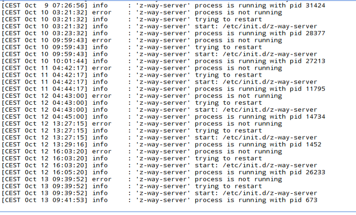

Re: Server halts and log is filled with "[E] [zway] SaveData
I don't know why I keep adding information to this thread as it is obvious that the Z-way people couldn't care less but anyway:
The server obviously dies from some reason. When i restart the server, the message is:
"Stopping z-way-server: start-stop-daemon: warning: failed to kill 1523: No such process"
Furthermore, when the server is running, it seems to consume a lot of CPU:
Linux 4.4.46-v7+ (zWave_Nexa) 2017-02-24 _armv7l_ (4 CPU)
10:28:14 UID PID %usr %system %guest %CPU CPU Command
10:28:19 0 14446 22,16 2,99 0,00 25,15 1 z-way-server
10:28:24 0 14446 7,40 1,20 0,00 8,60 1 z-way-server
10:28:29 0 14446 12,40 2,00 0,00 14,40 1 z-way-server
10:28:34 0 14446 19,40 3,00 0,00 22,40 1 z-way-server
10:28:39 0 14446 16,40 1,80 0,00 18,20 1 z-way-server
10:28:44 0 14446 10,00 2,60 0,00 12,60 1 z-way-server
10:28:49 0 14446 11,20 2,80 0,00 14,00 1 z-way-server
10:28:54 0 14446 20,80 3,80 0,00 24,60 1 z-way-server
10:28:59 0 14446 21,60 1,40 0,00 23,00 1 z-way-server
10:29:04 0 14446 21,60 1,80 0,00 23,40 1 z-way-server
10:29:09 0 14446 15,20 3,20 0,00 18,40 1 z-way-server
So the situation is the same as eight days ago: The lights in my house remains uncontrollable most of the time and the family hates zwave
I was under the impression that the people at Z-Wave.Me refers to this forum as the support venue but I'm obviously wrong. So where do one turn in order to get some support?
