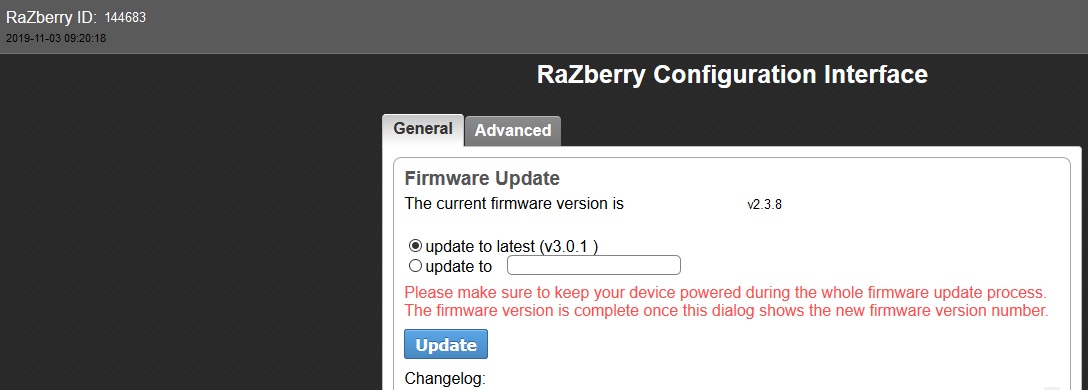

I tried today an uprade to new firmware (from 3.0.0 to 3.0.1) - was suggested in interface.
Upgrade finished with a message about a disabled webinterface (?) (do not remember in detail).
I have seen that still 3.0.0 was running and wanted to restart Z-Way - but in /etc/init.d/ was no more z-way-server command

Upgrade to 3.0.1 with:
# wget https://storage.z-wave.me/z-way-server/z-way-3.0.1_armhf.deb
# sudo dpkg -i z-way-3.0.1_armhf.deb

Re: suggested Update to 3.0.1 fails, Z-Way installation corrupt!
3.0.1 is only for Buster. On Stretch 3.0.0 is the latest. You can explicitly install it, but the script will reinstall v3.0.0
