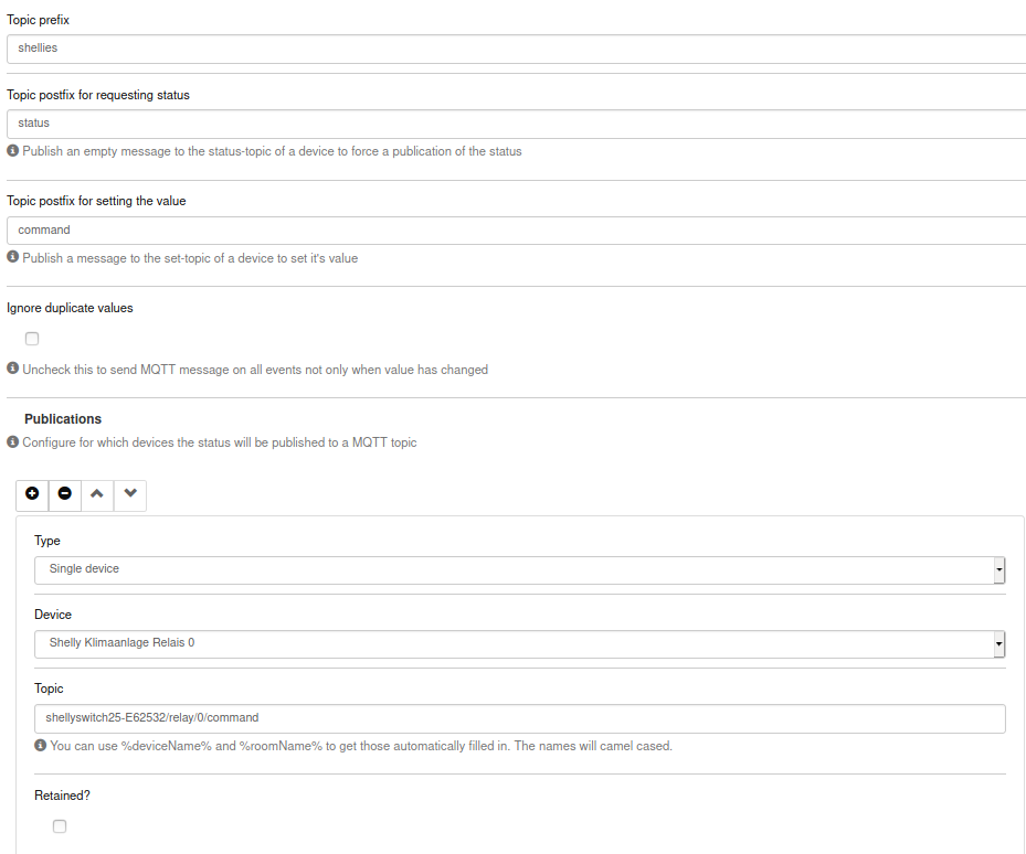

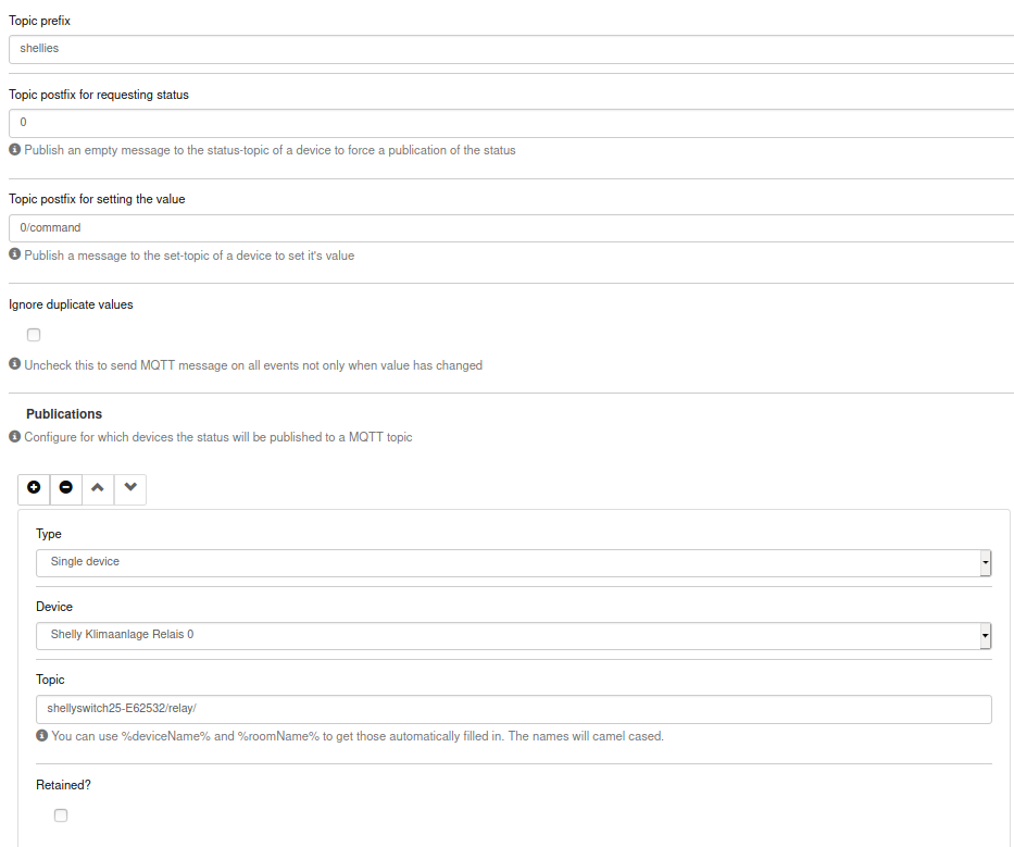

Hey Johannes,
I ran into the same problem with my shelly modules. The MQTT app does not fully fit the binding-naming sceme of the device.
Hence I instantiated two MQTT apps per device. One app configured to set the MQTT device and one app to catch the messages that the device publishes on status change. That results in unnecessary traffic, but it works
Regards,rws
Regards,rws
Re: Z-Way Tasmota and MQTT
Hi rws,
I tried that as well but seem to have created a permanent loop. When the device published a status change I was able to capture that and set the UI-device, accordingly. However, this change triggered to UI-devive to fire a MQTT message to the Tasmota device which responded...
In the meantime I overcame the issue using an HTTP device. Although, I would really perfer to use MQTT. Any guidance would be very much appreciated.
Thanks
