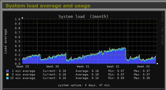

I frequently observer comparatively higher than usual CPU loads caused by z-way-server. I'm not log reading expert but nothing strikes me in particular. I do see a fair number of "Discarding duplicate packet" but even when the load is not high. When the load IS high, the log is equally quiet so it is not busily cranking out new errors or warnings. My current work-around is to just restart the server and I now have this done by a daily cronjob. I have quite a hand-rolled setup and I don't expect people to magically diagnose my issue. But perhaps something is already known which can cause this kind of build-up. If not, what would be the best way to diagnose this?

Me too,
Earlier I noticed it took 3 attempts to turn a light off, I assumed that was normal.
Z-Way is using 14.5% Processor on my Pi4, (14 days since restart)
Restarted sudo /etc/init.d/z-way-server restart
30 minutes later 0.6% processor
and things work properly.

Ok I'll try to get some more information. Note that when I oberserved this, there was practically nothing currently going on, ie not sensors were firing any more than the idle load. And we're only talking a handful of door sensors, a motion sensor and a few remote controllable power plugs. Not many automation rules present either.PoltoS wrote: ↑11 Aug 2022 02:00@micky1500 and @xurg, CPU usage might be higher when a lot of rules are working and when there are a lot of commands in the queue. Beside that the CPU usage should be pretty low.
I would suggest first to tun "top" and press "H" key to go in the thread mode. You will see zway processes like zway/webserver or zway/ttyAMA. Please let us know which is eating the CPU.
The lead to the command queue is interesting. Could there be some kind of build up in case a sensor's battery run out or so?
