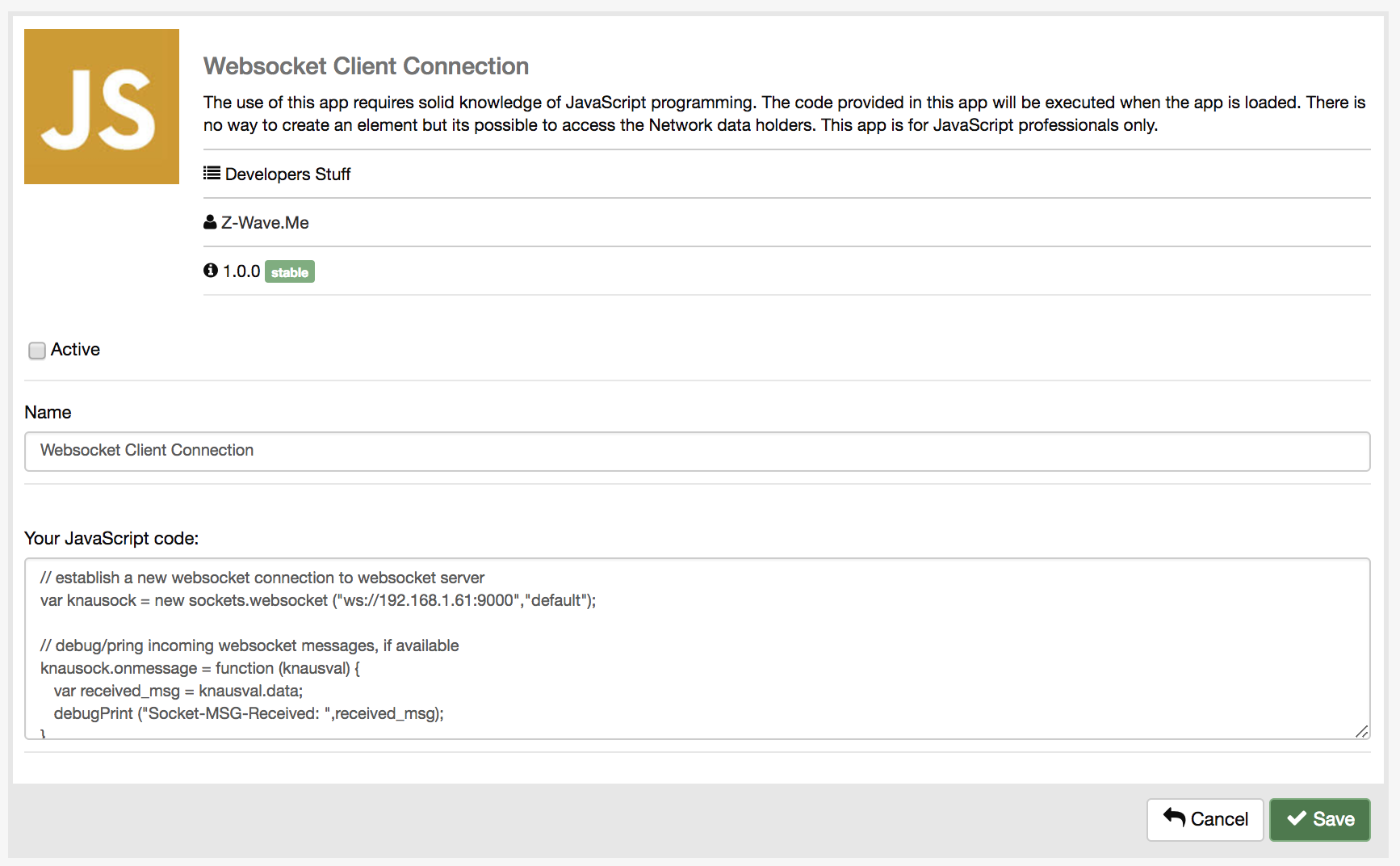

Step 2. setup a little JS-zwave-App as a websocket-client, with the following sample code:
// establish a new websocket connection to websocket server
var knausock = new sockets.websocket ("ws://192.168.1.61:9000","default");
// debug/pring incoming websocket messages, if available
knausock.onmessage = function (knausval) {
   var received_msg = knausval.data;
   debugPrint ("Socket-MSG-Received: ",received_msg);
zwave-ui-JS-websocket-app
ss 1.png (193 KiB) Viewed 10045 times

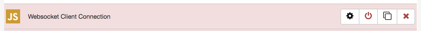

Now disable the JS-App in UI again and simply change the zwave-JS-App slightly by entering a different protocol type, instead of "default".
e.g.
var knausock = new sockets.websocket ("ws://192.168.1.61:9000","toptron-protocol");
zwave-ui-js-app deactivated
ss 2.png (20.11 KiB) Viewed 10045 times
