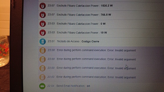

Same problem here. CentralScene interview fail and It generate notifications error when sensor polling (each 10 minutes):

[2019-12-17 11:30:01.007] [I] [core] Notification: error (module): Error durante la ejecución del comando: Error: Invalid argument
[2019-12-17 11:30:01.016] [I] [core] Error: Invalid argument

[2019-12-17 11:30:01.024] [I] [core] Notification: error (module): Error durante la ejecución del comando: Error: Invalid argument
[2019-12-17 11:30:01.036] [I] [core] Error: Invalid argument
