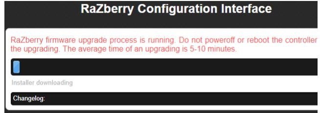

Since 1 nov i see in firme upgrade v4.0.0 versión but after click on update, i continue to see 3.2.3

I tried to update as well and the message below remains unchanged for a very long time ( > 16 hours). After that I restarted the system and everything was as it was before. Trying again to upgrade to 4.0.0 gave exactly the same result.

It is available as a .deb package, but has not yet been added to the repository. It will be added next week so you will be able to upgrade.

Thank you for contacting us with this question, yes, we are aware of this problem and we will fix it soon, but you can solve the problem yourself and connect via SSH faster and run the command:
cd /tmp && wget https://storage.z-wave.me/z-way-server/ ... _armhf.deb && sudo dpkg -i z-way-4.0.0-lws16_armhf.deb

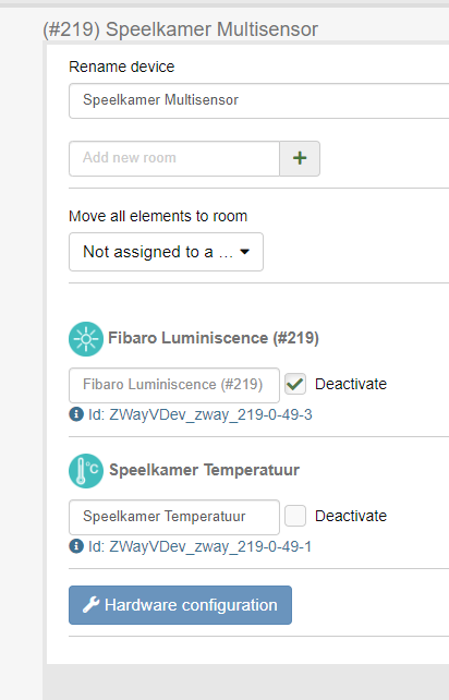

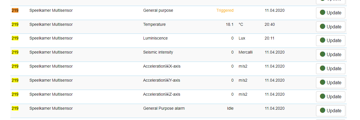

I just upgraded but now all fibaro multisensors (FGMS-001) are only showing luminsense and temperature, motion is gone...
In expert interface it still looks good... how can I get it back ?

I have exactly the same problem: I have 3 of these FGMS-001 sensors, all 3 are missing the motion sensor after upgrading to 4.0.0

Yep, I have it with all of them which is quite a problem, all motion based automation stopped working
Re: V4.0.0
Opps. Thank you for this info. I'll pass it on to our testers.
