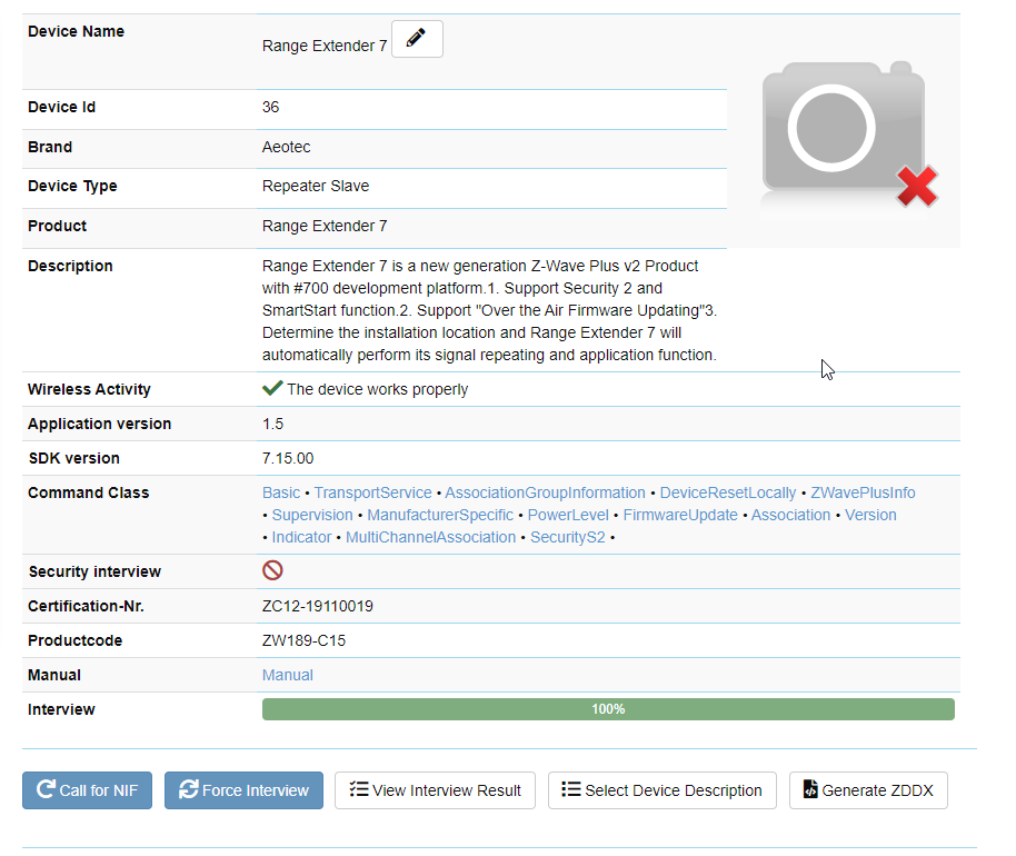

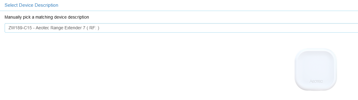

i have add an DeviceImage to an ZDDX File
 <resourceLinks>
		<deviceImage url="https://products.z-wavealliance.org/ProductImages/Index?productName=ZC12-19110019"/>
	</resourceLinks>
On Select Device Description it was Shown, but in the Device Configuration it was Missing.
2022-12-24 16_47_56-Z-Wave Expert UI – Mozilla Firefox.png (27.62 KiB) Viewed 7031 times
2022-12-24 16_48_32-Z-Wave Expert UI – Mozilla Firefox.png (25.16 KiB) Viewed 7031 times
Greetings from germany
Jörg

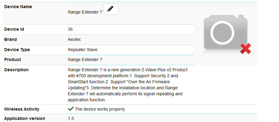

I have also done these things. It works.
Have you cleared the browser cache? If that doesn't help, the reason must be in the file. Either you are using a wrong file (unfortunately, the filename is not shown in Expert UI), or you made a mistake while editing.
I assume that you have edited an existing file and not renamed it or created a new one.

Post by piet66 »
I don't have this device.
I took the description of another device without image, added your image, and after I cleared the browsers cache the image was shown in Expert UI.

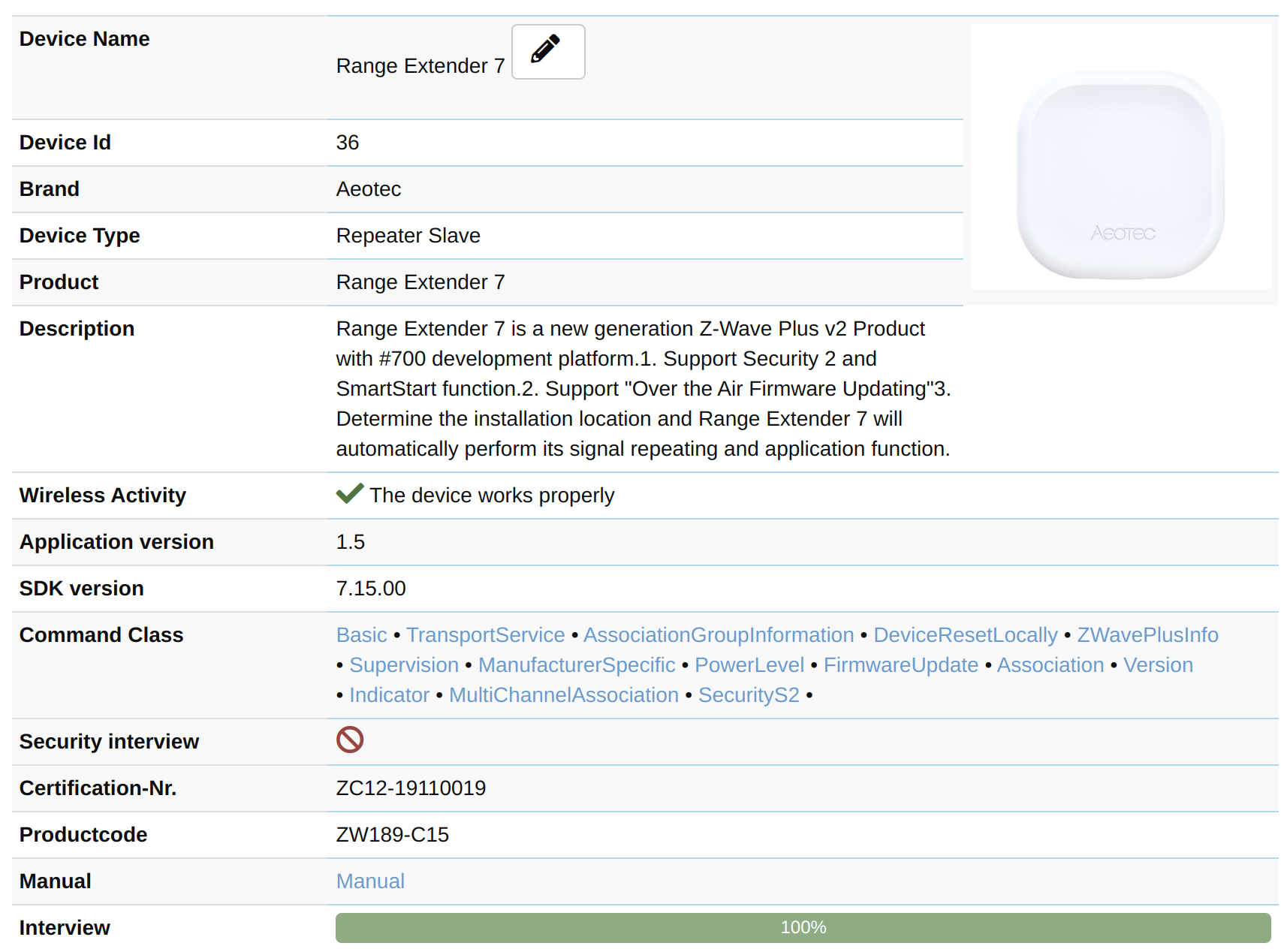

The picture points directly to the Alliance web site: https://products.z-wavealliance.org/Pro ... 2-19110019
Please make sure this site opens in your browser. I think it is an internet issue on your side.
