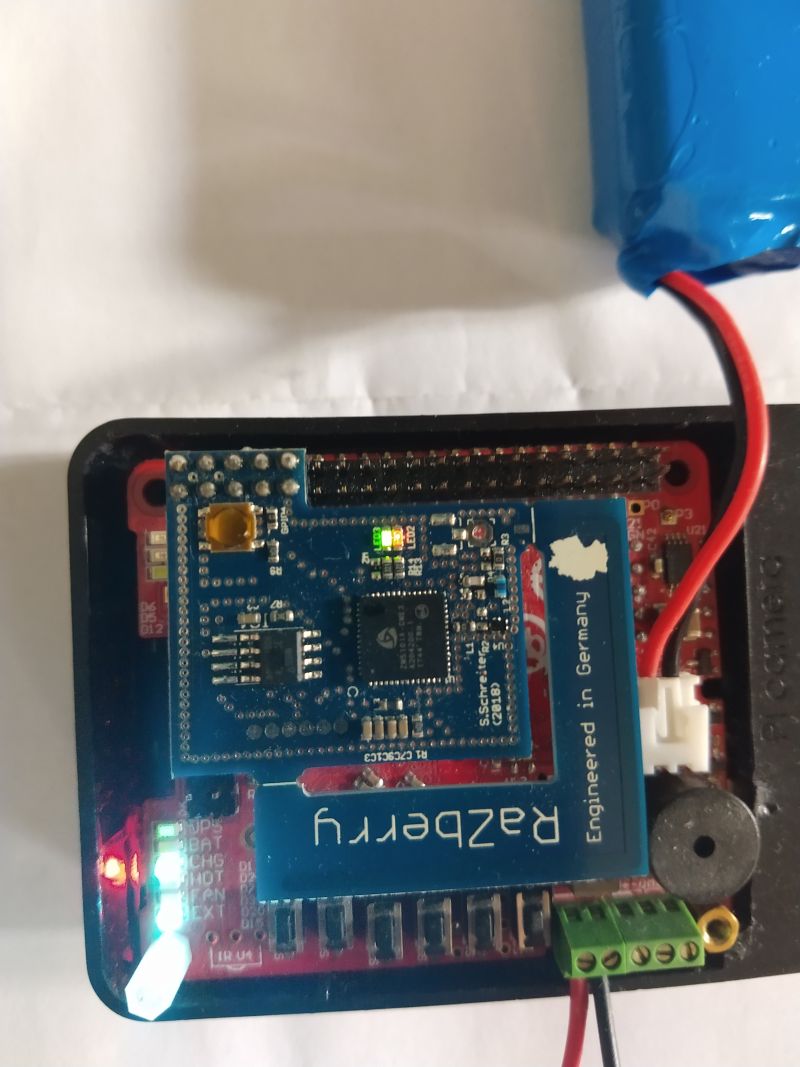

Hi PoltoS
sorry but another one dead Razberry2 board after firmware update,
ZMEERAZ2, rev.2.1 S/N 26.18.01 - on the white label
HW Rev. 2.0 - 11/04/2018 - on the board
Z-Way version v3.0.0
Now all LED are bright. No power loss by update. The whole update process looked fine ,no error message or something wrong .

21 Feb 2019 00:22
The problem is identified. Currently we do not see any options to upgrade except for returning then back to us. The problem comes from the factory and was not found during QC tests. We are working on other options. Only blue boards are affected
Currently we do not have any workaround. We are discussing this with contractor
Hi Poltos,
do you have any news regarding this issue?
How to do firmware upgrade for a blue-board RazBerry?
Re: razberry v2 shield problem (dead?) after firmware update
Blue boards were manufactured by our partners and have an issue with upgrade. Some to them gets bricked. Some are okey. You can not guess it until.you do the upgrade :( so just swap it to a new one under warranty
