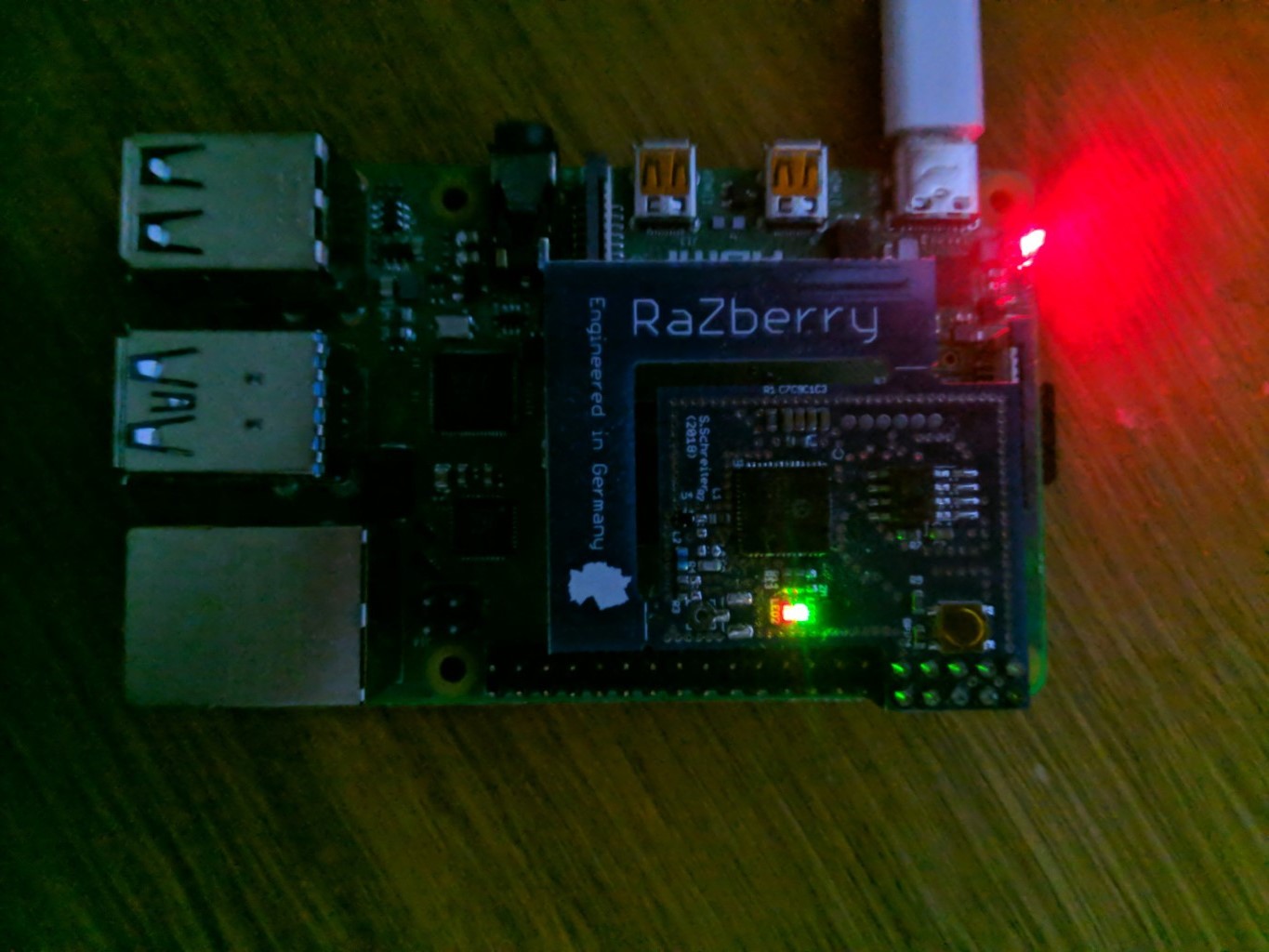

I listened to recorded webinar today, used the token to find upgrade and proceeded assuming that my device ZMEERAZ2 Rev.2.1 would be fine as I purchased it relatively recently.
However, after upgrading firmware the device seems to be completely dead.
z-way-server.log (attached) shows the process seemingly succeeding, ordering a soft reset and terminating the z-wave binding,

ZMESerialUpdater just keeps ticking away with (-->) apparently unable to open the port.
I have done multiple complete power cycles of RPI and am stuck.
Any ideas?

This seems to be a perfect duplicate,
https://forum.z-wave.me/viewtopic.php?f ... ro.#p84723
My leds seem pretty strong, not sure what it used to look like.

Think you answered your own question.
I'm sure Serguei said the blue ones were suspect in the Webinar (bad manufacture batch - fails upgrade).
https://forum.z-wave.me/viewtopic.php?f ... lue#p81821
Maybe Poltos will give some advice.
Re: Firmware upgrade brick?
Correct, blue boards are affected by this issue. If both LEDs lid faintly, it is dead. Please swap it in your shop for free.
