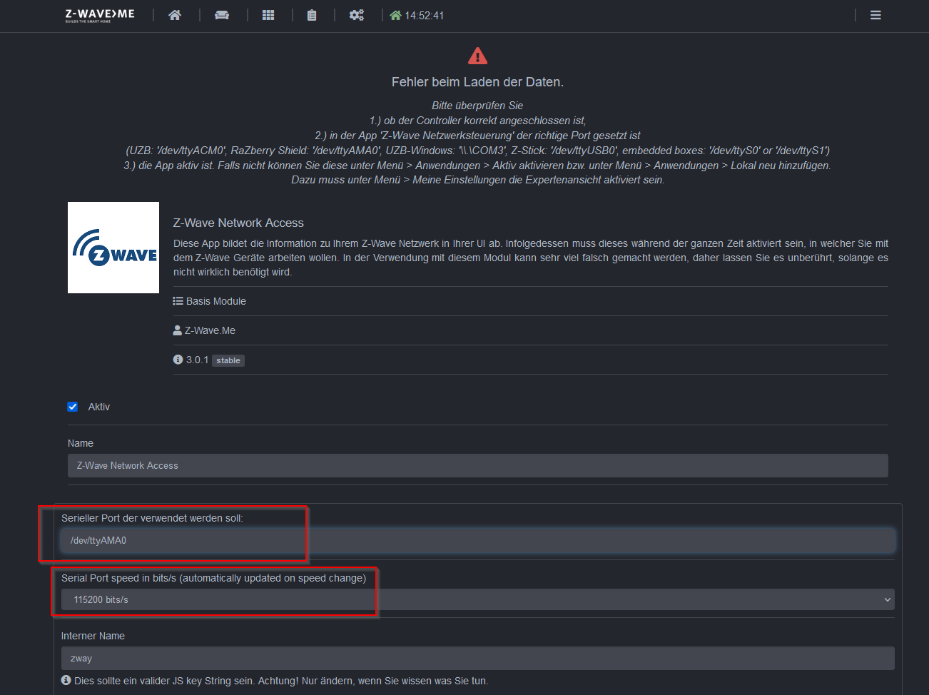

The server always tells me to proof, if the controller is connected an the correct port in the app is set.
The message gives me following possible ports:
UZB: '/dev/ttyACM0', RaZberry Shield: '/dev/ttyAMA0', UZB-Windows: '\\.\COM3', Z-Stick: '/dev/ttyUSB0', embedded boxes: '/dev/ttyS0' or '/dev/ttyS1'
in the app "Z-Wave Network Access" -
i tried the ttyACM0 and the ttyAMA0 and the versions with "/dev/ttyAMA0" but nothing works for me.

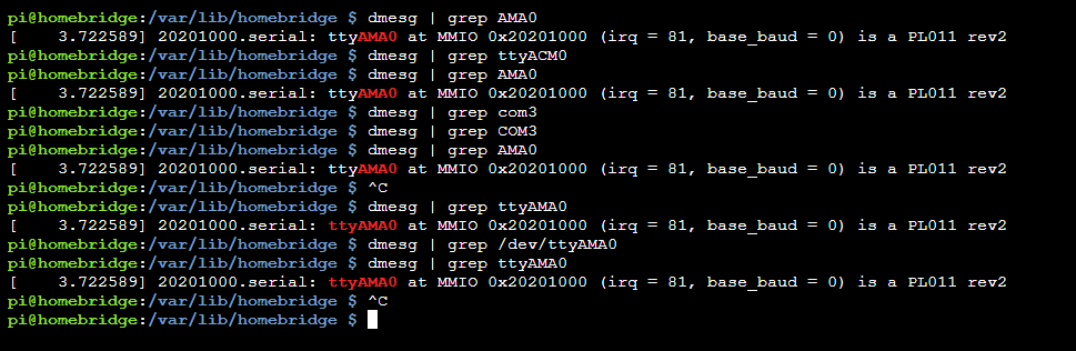

i found a hind, to check the port via terminal, i tryed "grep" command and got following:
(the other ports led to a blank output line
pi@homebridge:/var/lib/homebridge $ dmesg | grep ttyAMA0
[ 3.722589] 20201000.serial: ttyAMA0 at MMIO 0x20201000 (irq = 81, base_baud = 0) is a PL011 rev2
Can anyone help me an tell, what i'm doing wrong?
