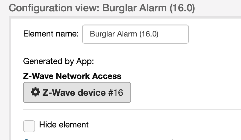

I've tried,jor URL, but didn't work, I get an error:
TypeError: Cannot read property 'set' of null
This is what I entered in the address box:
http://192.168.1.12:8083/JS/Run/controller.devices.get("16").set("metrics:probeType","alarm")
As I guess my device ID is 16:
But I also tried with 16.0
Maybe I'm doing something wrong...

Ok... My fault with the VDEV... It was not something like 16 but something like "ZWayVDev_zway_16-5-113-8-10-A"
Now I get a error-free answer:
