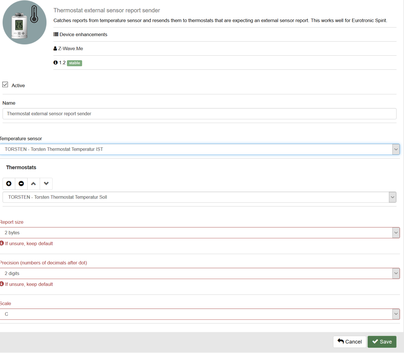

Hi there,
I tried feeding back the data to the spirit and here are my results. For comparison, I let the spirit run 24h with a fixed target temperature of 19°C. To see that the values are real, there is an open window for 5 minutes last night that you can see in a temperature drop and resulting overshoot from the spirit.
This morning I switched to the app aivs reported, in version 1.2, freshly installed and set up. All I do is looping back the reported temperature to the spirit, please see attached screenshot for config details.
The attachment Z-way_config_2019-03-08 15_53_15-Z-Wave Smart Home.png is no longer available
Now you can see the resulting temperature in the room constantly climbing over the course of the day. Nobody in the room, no external source of heat, it's cold outside, no sunlight heating up the room.
The attachment Z-way_temperature_2019-03-08 15_49_39-Z-Wave Smart Home.png is no longer available
What am I doing wrong? The spirit parameters are as follows
Z-way_config_2019-03-08 15_53_15-Z-Wave Smart Home.png (69.57 KiB) Viewed 15246 times
Best Regards,
rws
