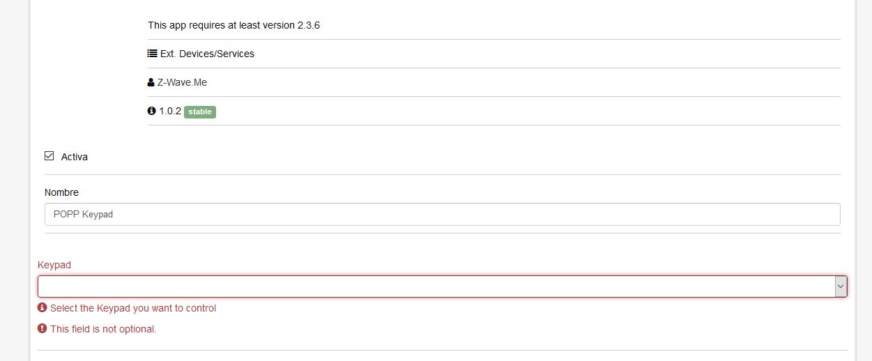

tried to make my Popp keypad run. But I can't manage it:
1. The module requires the input of the chosen keypad, but the enum menu remains empty. Reason I think: there's no device 'devices_sensorBinary:tamper' created. Exchanged in module.json "namespaces:devices_sensorBinary:tamper:deviceId" by "namespaces:devices_battery:deviceId" to be able to select the battery device of my keypad.
2. After storage of the config message 'Something went wrong'.
Log-messages:
[2019-08-27 14:31:27.962] [core] Notification: error (core): Cannot instantiate module: PoppKeypad: TypeError: Cannot read property 'data' of undefined

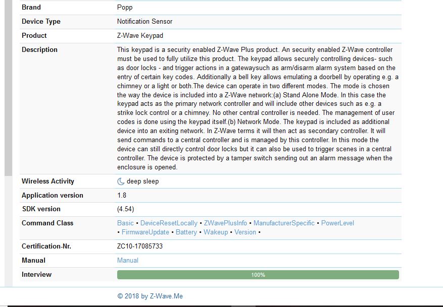

The same problem here. In v2.3.8 it's ok, but v3.0.0 interview problem in secure mode, never 100%. I only interview completed with no secure mode inclusion, but Popp KeyPad App no display device to select. In Network -> Neighbors does not appear.

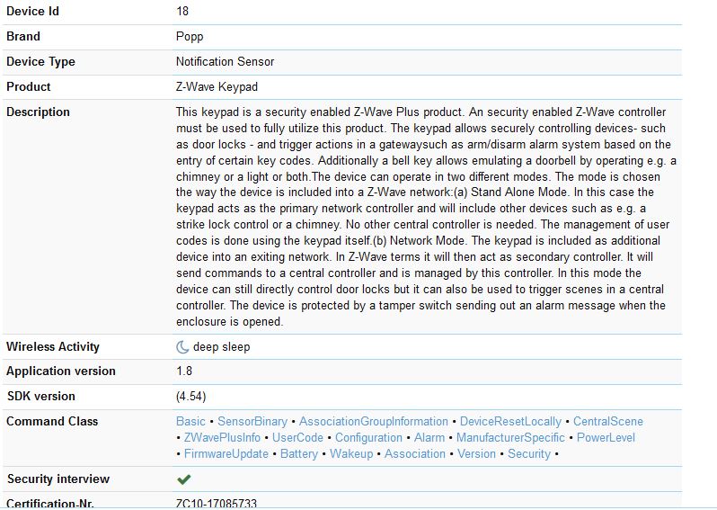

as I already told I finally managed it to run.
Some hints what I would observe, when I would do it once more:
- put keypad close to controller for interview
- include in secure mode
- be patient, it needs very long time
- observe log file during interview process
Here you can see more interesting info, like
security interview started, timed out, failed, finished
- never call for NIF during interview process, cause it breaks security interview.
Good luck!

Thanks piet66, it worked for me!!! I have included keypad in secure mode from expert mode, i have checking log inclusion and keypad antene at 10 cm of Razberry antene.

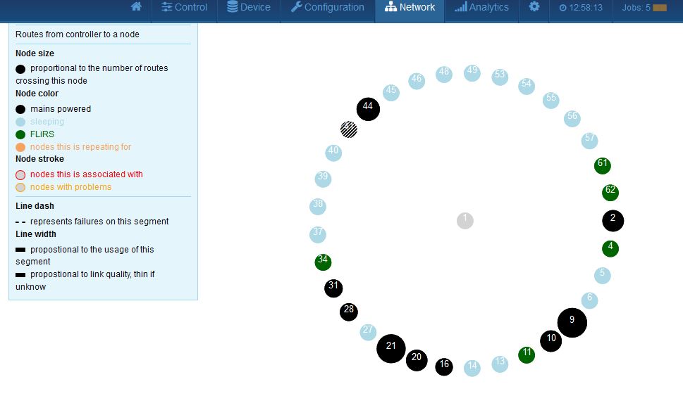

I have view another problem, the device not appear in Neighbors and Route Map in expert UI.
piet66
Posts: 281
Joined: 04 Feb 2017 17:00
Re: Module PoppKeypad doesn't work
Post by piet66 »
That's correct. It has no neighbours.
It's something like a handheld, which can be moved around. It's not useful to store neighbours for such devices.
