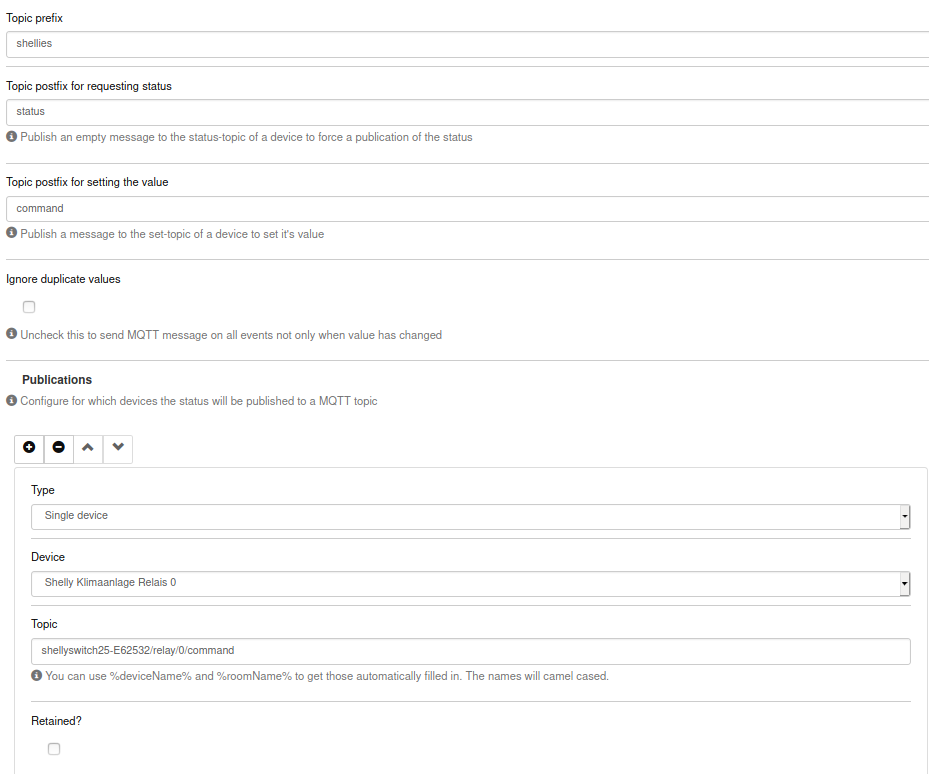

Hi Johannes,JohannesF wrote: ↑23 Jan 2021 11:08Yes, I had tried that as well but it didn't seem to help. What I believe is happening is the following:
When the button on the tasmota is pressed to switch on, it sends a message which is used to change the status of the UI device from OFF to ON.
The UI then fires e.g. a POWER ON cmnd to the device which is already on. The Tasmota responds with a new status=ON message which shouldn't do anything to the UI device as the status doesn't change. No clue why the cycle doesn't stop.
I could imagine that I had not selected the most suitable MQTT topics. So if anyone could share a working example including the MQTT topic and prefix settings of the device that would be highly appreciated.
Regards
Johannes
It has been a while since I set this up, but I simply took screenshots for you. Hope that helps, no loops in my setup. One is the catcher, the other the setter.
The Shellies produce a noticable amount of traffic but WIFI is sort of beefy enough for it.
Best of luck,
rws

Re: Z-Way Tasmota and MQTT
Thank you, rws!
With your and Michael's help I was able to make a huge step forward. I am now able to switch a Tasmota flashed Gosund via MQTT and the dummy device will also listen and react to any manual switching on the device itself. Heureka!
Next on my wish list is to read the sensors of a Tasmota but I struggle to set up a UI device to display the readings. One step after the other...
Thanks again, guys!
Johannes
