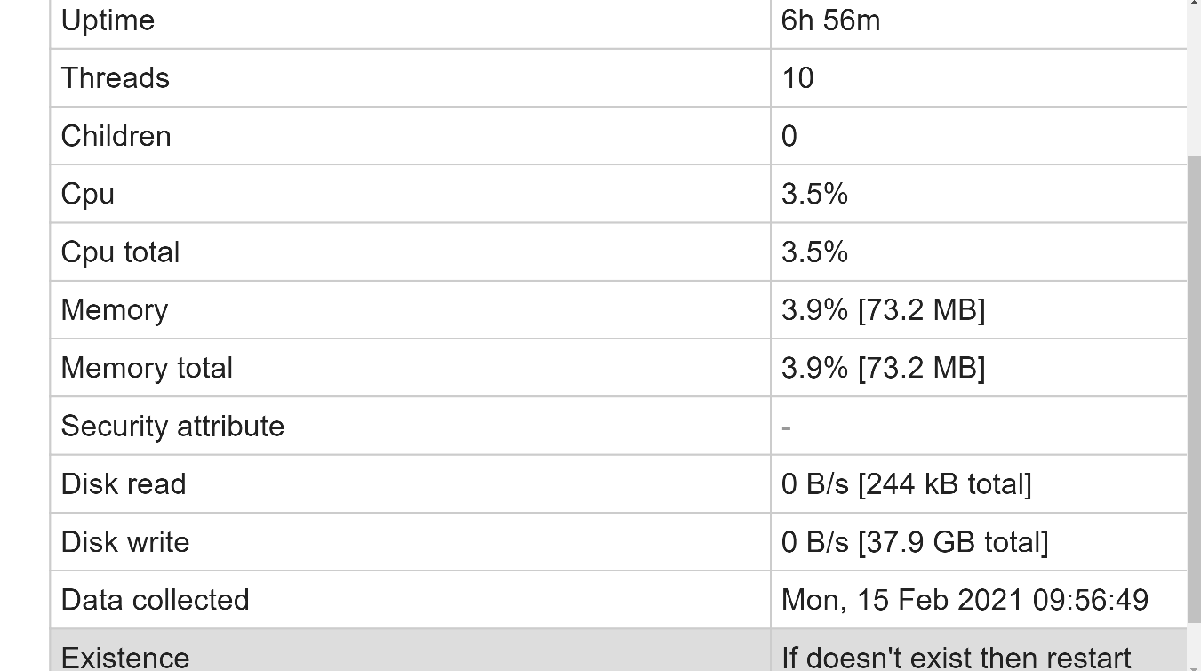

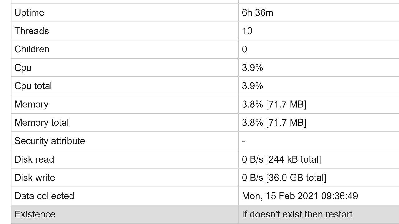

I installed monit after reading of it earlier in the thread (thanks micky1500), yesterday evening I reboot the ZWay Rpi then this morning I see that in 6hrs 38minutes it has a disk write value of 35.8Gb. Then only 18 minutes later there it's up to 37.9Gb, another 1.1Gb. Surely this can't be normal, at that write rate it's no wonder my SD card failed?

Rpi4 2Gb, Z-Way 3.2.2, UZB 5.39

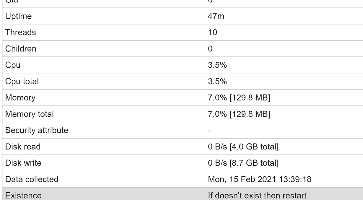

I setup a fresh install, latest buster & ZWay to rule out any other issue's causing the disk write. So now after only 47 minutes it 8.7Gb written to the disk. Is this normal?
