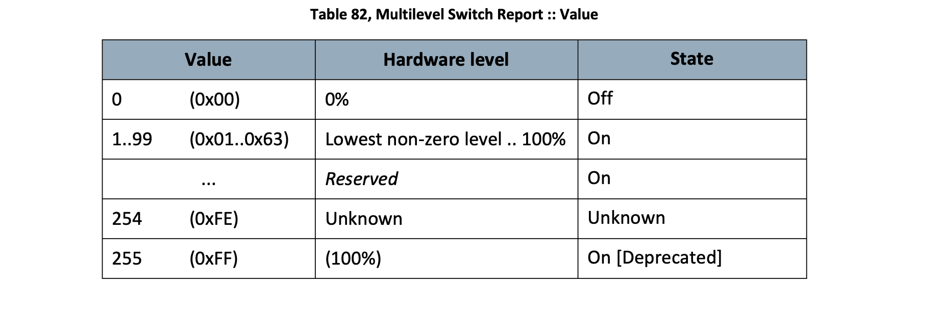

The reason for this is because 0xFF was deprecated:
Switch Multilevel specification
Снимок экрана 2021-05-24 в 13.34.53.png (91.48 KiB) Viewed 16994 times

BTW,
the 0xFF value has been deprecated only for the Multilevel Switch Report Command, but not for the Multilevel Switch Set Command. This means a device must be able to respond to 0xFF values in Set commands, but should not report a 0xFF value when reporting back to Controller or other associated nodes.
Re: CC command multilevel switch with 0xFF
Well noted. We will check it again
