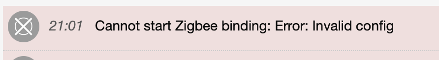

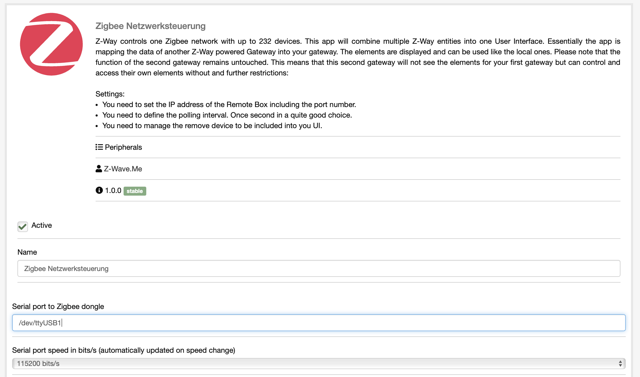

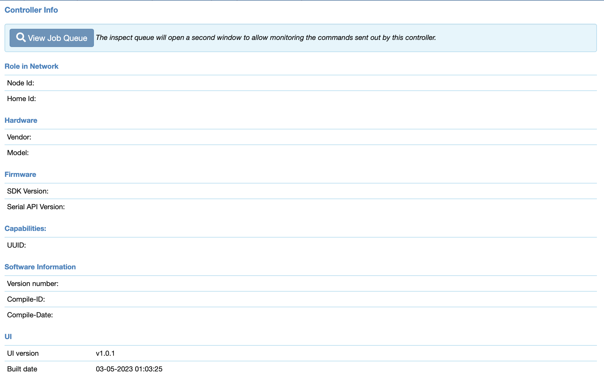

Bildschirmfoto 2024-04-20 um 20.59.51.png (267.35 KiB) Viewed 32609 times
Bildschirmfoto 2024-04-20 um 21.01.42.png (21.59 KiB) Viewed 32609 times
Bildschirmfoto 2024-04-20 um 21.05.49.png (174.45 KiB) Viewed 32609 times
It simple doesn’t work?!
After not having success with Z-Way. I tried ZHA and ZigBee2MQTT but also without having success.

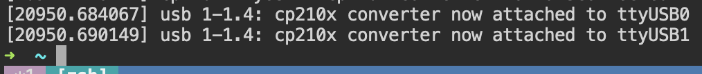

Try at Raspberry console:
 dmesg| grep tty
there should be something like that:
[   11.835361] usb 1-1.4: cp210x converter now attached to ttyUSB0
[   11.844992] usb 1-1.4: cp210x converter now attached to ttyUSB1
Have you something else connected at USB ports?
And - what is your Z-Way version?

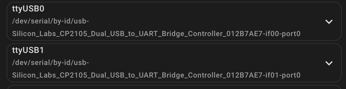

I'm running Home Assistant OS on Raspberry Pi4
No other USB Devices are attached.
And the Z-Wave.me Addon, Z-Way Server v4.1.0
Bildschirmfoto 2024-04-20 um 21.32.19.png (28.05 KiB) Viewed 32603 times
Z-Wave ist working fine, but ZigBee not!
Bildschirmfoto 2024-04-20 um 21.31.13.png (50.36 KiB) Viewed 32603 times
