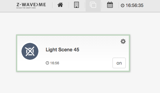

Tried at home now but still getting two notifications. The thing you mentioned is de-activated. What else can trigger so it sends two notifications instead of one? (Attached some pictures)

Z-Wave Support
Posts: 353
Joined: 21 Oct 2016 15:49
Re: Push-Me (Pushover) sends doublets of all notifications
Post by Z-Wave Support »
why send your Sensor a on and a off in the same time? Send you a push, if it open and close or only by open the door?
Best regards
Z-Wave Support

have you checked, if you have twice the scene ?
Best regards
Z-Wave Support
benis
Posts: 29
Joined: 15 Apr 2016 16:07
Location: Stockholm, Sweden
Post by benis »
I have not that many apps installed and not a single scene as far as I know. Should I look somewhere else that here?
