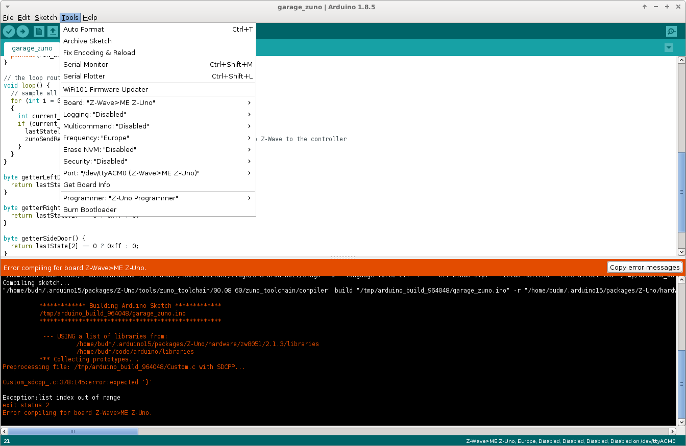

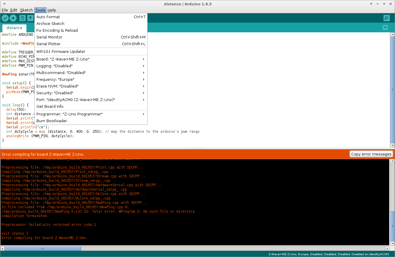

I've never been able to build 2.1.1 or later (currently trying 2.1.3) on Arduino IDE 1.8.5 on Linux. One compile fails trying to include "WProgram.h", indicating that the '#define ARDUINO 152' line in the board headers isn't being defined, or is being redefined somewhere (or something).
Switching to any other Arduino board works perfectly. As it stands, none of my software compiles for the Z-UNO with IDE 1.8.5/Linux.
Re: New 2.1.1 release!
Can you show your board settings under Tools menu? I use 1.8.5 without any problems.

Post by budm »
Screenshots attached. First one is trying to compile a simple z-uno app, second one is trying to compile a ping app that requires no zuno-specific libraries.
Post by p0lyg0n1 »
Z-Uno don't have WProgram.h. It's a very old header from Wiring. Use "Arduino.h" instead.
