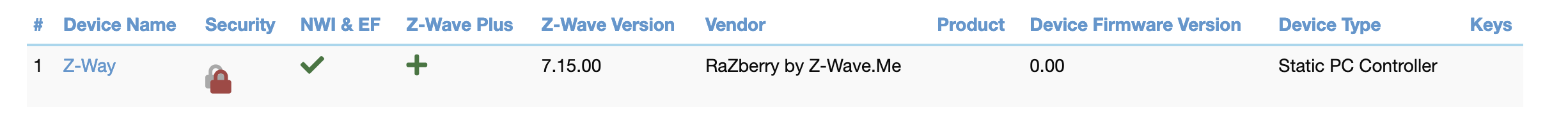

trying to figure out howto get my razberry to latest firmware.
It comes with 7.15.0 from what I can see in expert ui.

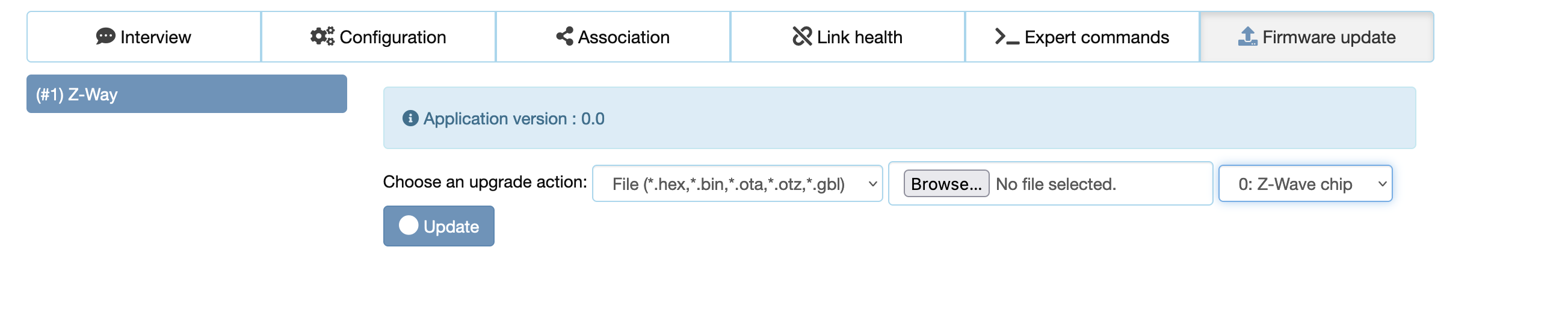

Hmm on my firmware update page I only have the option to upload a file or insert an url. (fresh install of z-way)

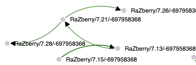

edit: perhaphs you ment all on graph page? If so would "active" mean stable release and "all" dev+stable releases?
Still don't understand how to follow the versioning in the graphs, those number really says nothing to me without any doc.
Arrows go 7.15 -> 7.13 -> 7.21, wouldn't it be 7.13->7.15.->7.21 ?

Also getting confused on what "firweware/sdk" I really have on my device. 7.15.00 does not seem to exist.

You are not looking at the correct page, go to Network -> Controller Info and then look near the bottom for firmware update. The page you're on is usually where you update the firmware for Z-Wave devices. There was a thread on all of this under the correct category. You might want to look at the Razberry sub-forum and look at that thread before proceeding any further.

Thanks :D
That page worked better.
But seems only 7.13 was shown. Can see 7.21 if i enter token "all" but don't want to upgrade if it's not stable.
