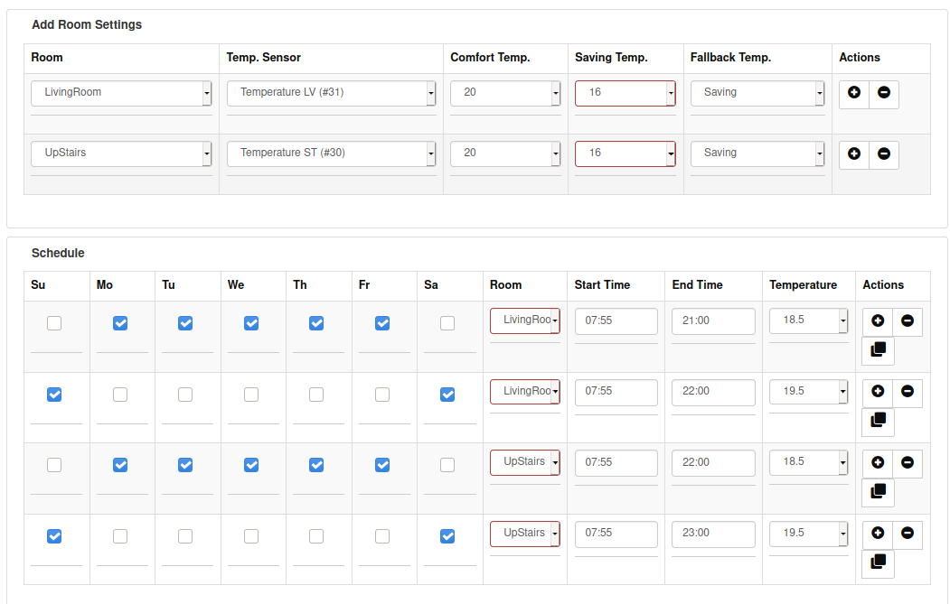

Same problem with Climate Control. Morning schedule works, but it doesn't come back to Saving Temperature at "End time" unless I enter in configuration and Save again or changing the operation mode and come back to "time driven". Schedule another period beginning at 21:01 neither works.
Screenshot from 2020-11-10 22-04-36.png (55.85 KiB) Viewed 11185 times
Re: Heating control nor climate control app are working
Thank you. Passed to our R&D so they look on it. Looks like it's getting cold in Europe
