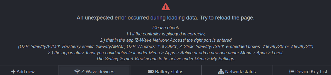

2021-02-07 15_09_55-Z-Wave Smart Home — Firefox Developer Edition.png (25.28 KiB) Viewed 10071 times
Re: RaZ board dead
Delete failed nodes from Expert UI
You can do local backup using curl - the request for backup is simple via API call.
